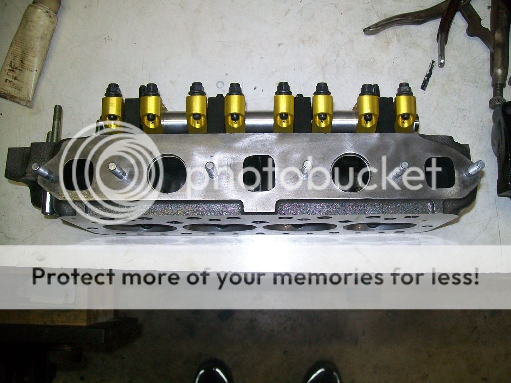

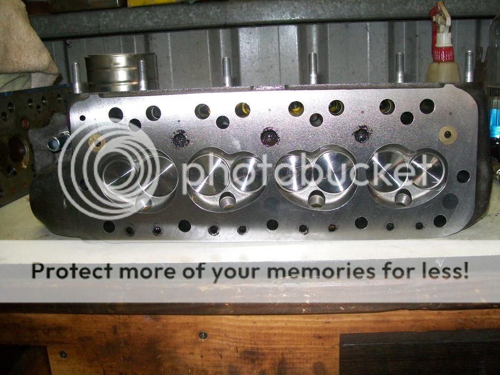

Well i have finished modifying this 12G940 Head from a 1100S morris
Ported and polished to what i think is neither too much or too little
New Valves and Bronze guides
Double valve springs
Exhaust seat inserts
MED 1.5-1 roller tip rockers
Extra holes drilled for Cooper S
She is all ready to be fitted
1970 MK2 Cooper S

Looks nice. Watch those bronze guides though, Minispares phosphor bronze ones tend to close up when fitted and need reaming. Then when run up to temp they can shrink further.
I had to ream mine, twice, with a 9/32" solid reamer. Once when built, then again when a valve started to grab. OK since. Now done 50,000 miles.
Other suppliers may have better bronze guides.. ;)

Hi Doc
Yes they got the reamer treatment as per the instructions that came with the guides
When you do it yourself it gives you a scene of achievement
That's until it craps out on you and you wish you had someone else do it :shock:

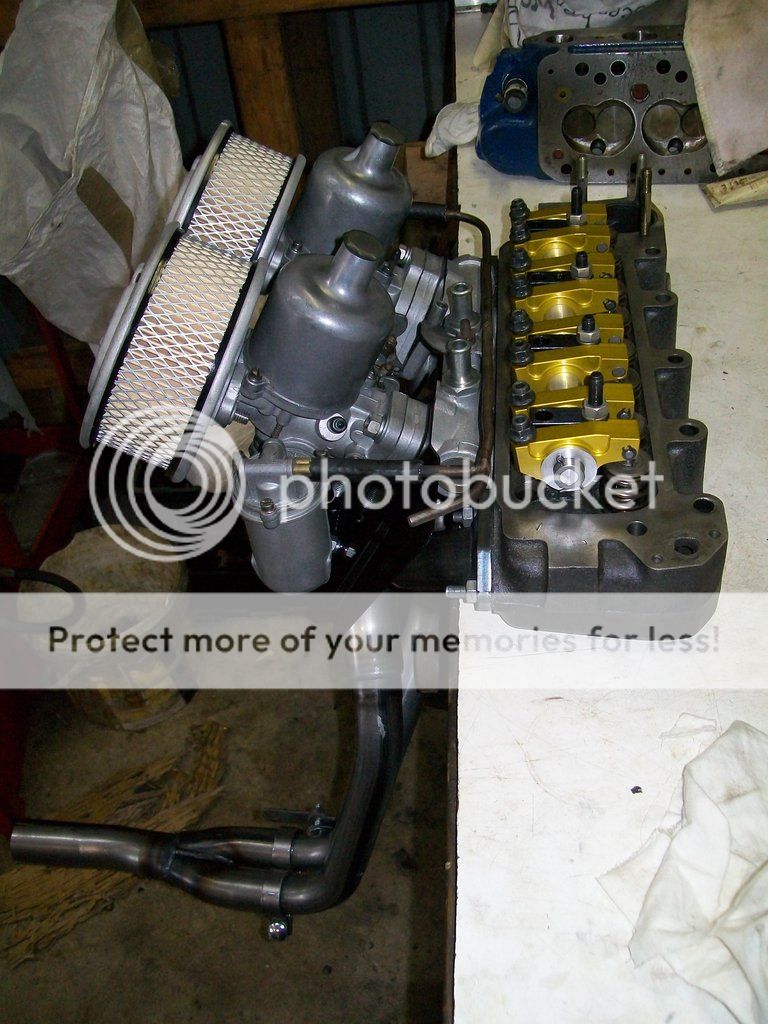

Here is the head with the extra bits on it
Seeing if everything fits

When we put these rockers on Jenk's S motor they needed 2mm packing shims under to get adjustment.
This was on a Mk1S head.
Nice rockers though! :)
