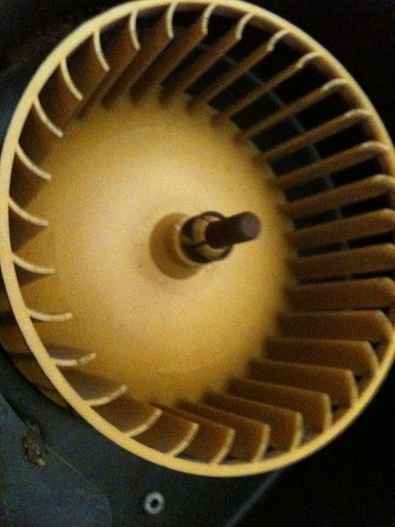

What material do I use on the metal flap and how is it positioned?
How do I remove the fan from the spindle?
Thanks for any info.
Eiles

Just slide the fan off the spindle, it just presses on.

I'll give it a good go. I was a bit hesitant using too much force in case there was something holding it in.

I'd just watch the plastic fan after 40+ years the plastic could be brittle and break

re your question about flap seal material, when I did up my `matic heater I used closed cell foam on it. it's about 6mm thick.

I used circlip pliers to remove the metal clip from the fan first as this is the thing holding it tight. it is a tedious job to remove it but patience is your friend. clean the shaft with some emery paper and spray with some wd40 or similar before removing the fan.
