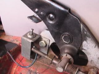

I don't have one that I can take a picture of straight away but it is just like a door light switch with a little bracket to hold it under the edge of the handbrake lever.
PostPosted: Thu Nov 04, 2010 7:19 am
Posts: 730
.... and you wire it by picking up a switched and fused active wire to one side of the globe, and the other side of the globe goes to the switch which earths it to the body when closed.

This is the switch installed as part of SPO41 (Police specification MK II S). The switch is a Linread, same as a Mini roundnose door switch and the holder and tab are fabricated.

The 1275 LS was the same as this set up (from a 1978 Clubbie S)

I'm not sure if you are talking about a roundnose mini or later. For police spec. roundnose switches like winabbey has shown, the power is picked up from the voltage stabiliser/regulator unit mounted on the speedo housing at B (battery) terminal, then to the warning light and earths at the Linread switch to body.
