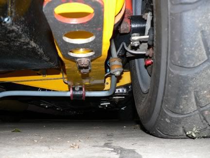

hey guys is having a rear sway bar fitted make that much difference ive been told that it does what are your opinions. plus where are they mounted photos would be good to.
cheers dan

However on-track I think it makes a great deal of difference. I have driven my car both with and without a rear bar on the same track (the only good comparison) and was able to get power out of the corner far earlier with the bar in place. So much less roll, more stability. Even on really bad tyres I was basically able to get controllable oversteer.

I'm just waiting to see what my WoF guy says 8) I went through the rules and in THEORY it's ok as I made no modifications to the suspension or chassis to fit it (holes were already there from previous installtion when I put it through LVV), but you never know. Worst case scenario I take it off until track day, like I said, not needed on the road.
