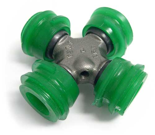

I run QL5000 uni joints. They are a replacement for the rubber unis. Unfortunately they are out of production. :cry: (Mine are white nylon)

All the Mini shops used to sell those QL5000s but they are now NLA (no longer available).
The joint inside is a normal Triumph TR6 uni joint.
There was another version with alloy caps not nylon- maybe someone with CNC facilities (hint, TheMiniMan) might make a few million up and sell em?? :P

You used to be able to get them from good spare parts places (Repco was good 20 years ago) Actually Repco use to make their own ones with black nylon. I would bet that there are some sitting on a shelf somewhere in Australia.
I got my last one at Scotts Auto One spares in Leura in the Blue Mountains NSW about 10 years ago. Mine look like this... (not my photo)
You can actually fit new unis into the nylon cups. I think that they were TR6 or similar unis.

I reckon those caps would not be hard to turn up from alloy or nylon, the shoulder ring would need to be left as a full circle and milled out later. :wink:

They were made for Minis and Morris 1100s. They were made by Quinton Hazell and the part number was QH5000. There was a larger one made for the Austin 1800 but these will not fit a Mini.

No. They will last for ages. The nylon will probably never wear out. The Uni will last a lot of years but if you pull them out and re-grease them every time you have them apart you will get a longer life.
I just looked up the QH book on the net and the part number is still in the UK book. (Rover Group -> Mini)
