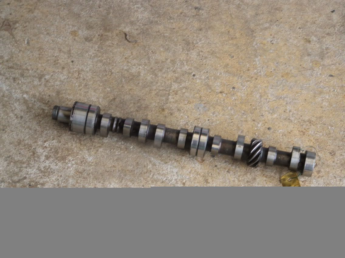

I know it's a big ask but have you any idea what sort of cam this is. I'm guessing it could be a Mk 1 S cam and not from an 'auto' because it has a normal slot in the end for the oil pump.

lobes are too narrow to be an S cam, don't know what it is though sorry.

Highly unlikely to be out of any S. Has lobe for mechanical fuel pump.

Two rings with 3/8" lobes is an auto cam for both the mini and the 1100.
According to the Vizard book it has exactly the same specifications as a Cooper S cam in terms of timing values and lift.
The Cooper S cam has a wider (1/2") lobe.

Not after a different cam (at the moment), but some time back when we rebuilt an 1100 for Ribena, the guy gave me this cam and said it was from an auto. That's questionable- because of the oil pump drive - (refer to Kevs post earlier) so I was just curious to see if anybody could shed some light.
The engine runs well, except at the high revs (dont have a tacho). Maybe the timing is just a whisker out or perhaps it's running one or two flats too rich or lean. Got to get it sorted.
