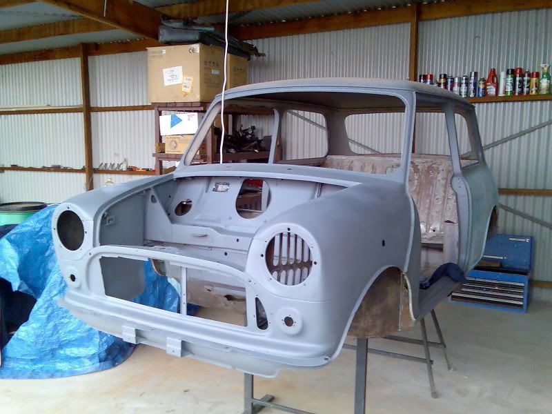

Take this front - notice there are no holes to put the bolt through.

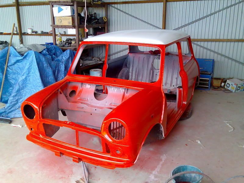

And then see it FULLY PAINTED!!!!! What do i do!?!?!
PostPosted: Wed Feb 07, 2007 6:50 pm
you can just make out the tow hooks connected to the subframe on this sportspack rover..not sure whats going on with your panel but all the ones i have seen have holes..
PostPosted: Wed Feb 07, 2007 6:55 pm
Do the new panels come like that or did someone cover them up? :P
PostPosted: Wed Feb 07, 2007 6:58 pm
It kind of is like a rear beaver panel with the later cutouts.....
Oh man that is a fix...

I've had a close look and the guy i bought it off has bogged up the holes. I was so keen and eager to paint her i didn't even check. :x
Anyways, water under the bridge i suppose. I was wondering how big these rubber mounts were. I was thinking i could make up some secondary brackets and weld them on with maybe a welded nut or enough room to get a ring spanner and nut in. This would take the space of the rubber and mount it up like normal minis. How does that sound?
