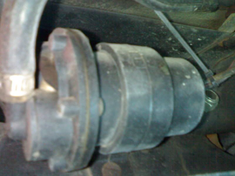

Car wont start today, no fuel pump ticking when ignition is on.
Tried tapping it and still no go.
So I'm buying a new one just wondering which one should I get?
I've read the solid state facet type is good
What type of fuel pump do I have?
Image[/img]
What's the easy way of replacing the fuel pump?
Should I install an inline fuel filter between the tank and pump?

No comment on the type of pump except I think it's a generic plastic type , someone else can vouch for it's proper type . The easiest way to replace it is get two pairs of vice grips and clamp the fuel lines either side of the pump (go a bit further towards the tank so you can fit a filter if you want) and then take the old pump off and fit the new one . A filters a pretty good idea but not necessarily essential as an SU hasn't got fine jets to block up as other carbs .

Your pump is an SU AUF201 or similar.
It may just need some TLC, clean the points etc. :wink:
