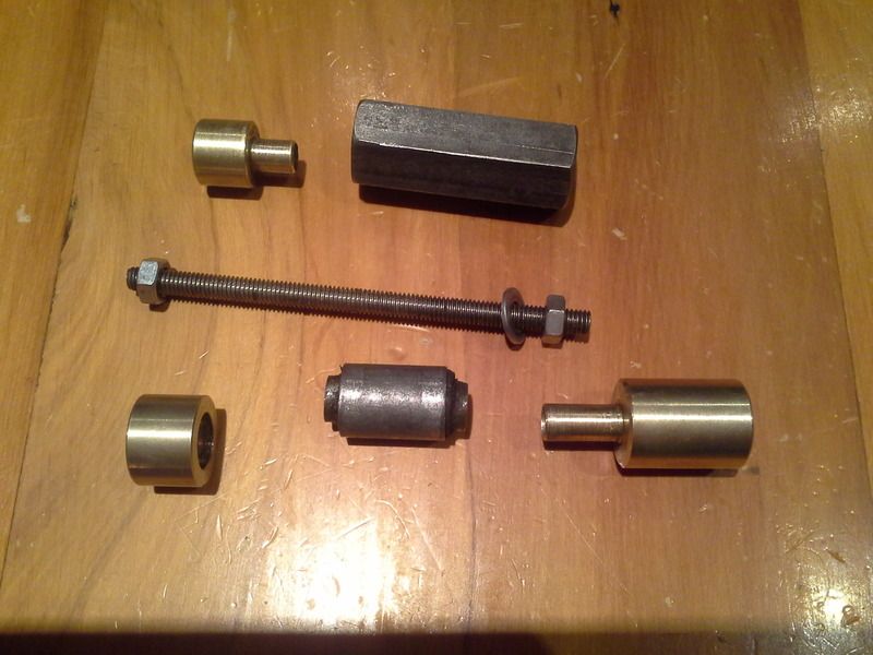

Made a rod change support bush installer and remover.
Some one was asking about doing it the other day
They are made from scrap bronze. The material is super hard.
I know you could use a couple of sockets. But I like making tools to use on the mini
