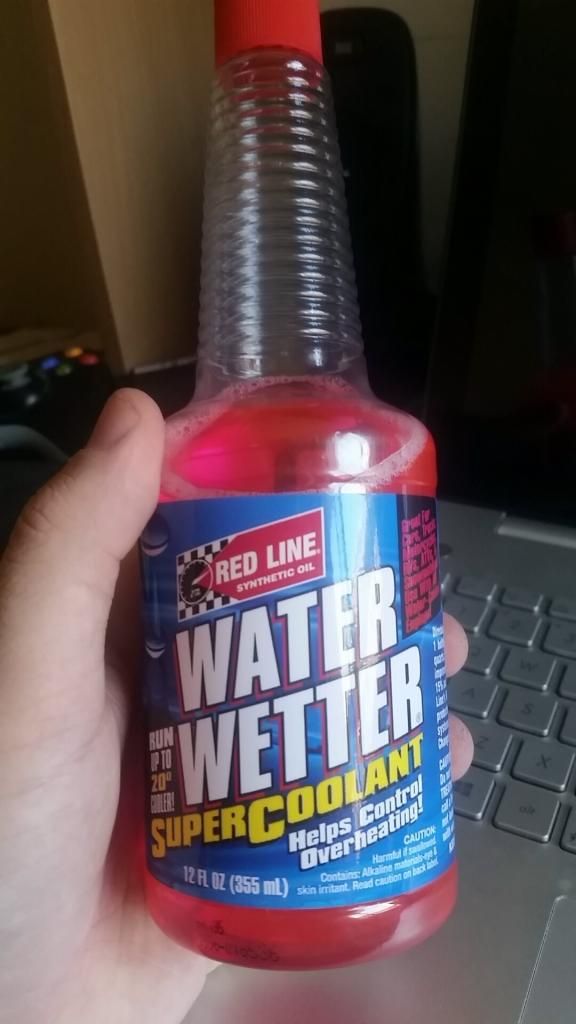

Also picked some of this stuff up to try as I've heard great things about it.

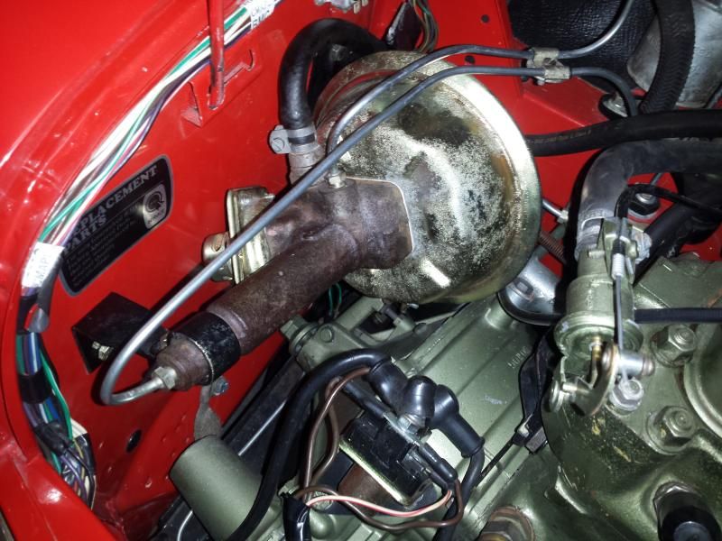

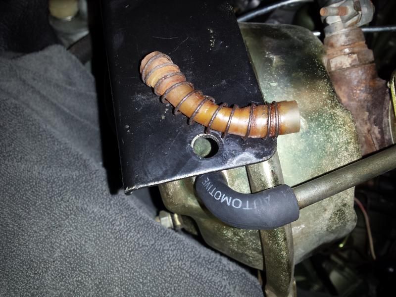

The mini I noticed would apply the brakes by itself whenever I started the engine up. I couldn't drive it as it was like the handbrake was on. It would release the brakes when I gave the engine some gas however, so it must have been the booster. This is the first hiccup I've had since the car was finished being restored 5 years ago.
I took the booster off without disconnecting the brake lines in the hope it was something simple....and luckily it was.
The little elbow hose venting the back of the diaphragm to the air valve had come off through age. I wonder why I used the old bit of pipe when a simple bit of 6mm hose would suffice...never mind, I must have promised myself an original part. All fixed and back in service.
