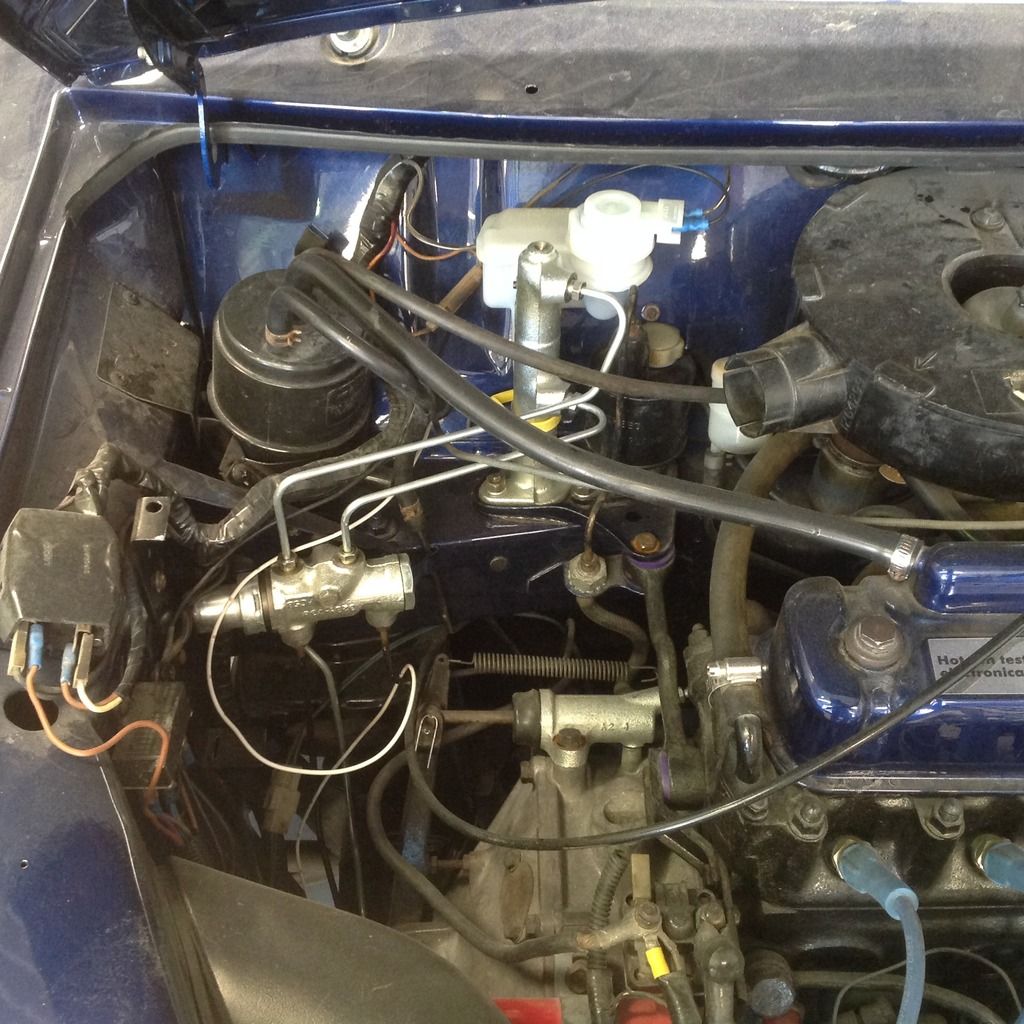

Soooo.....
New Brake Master Cylinder + new Brake Regulating Valve + new brake pipes = BRAKES!!
:D
