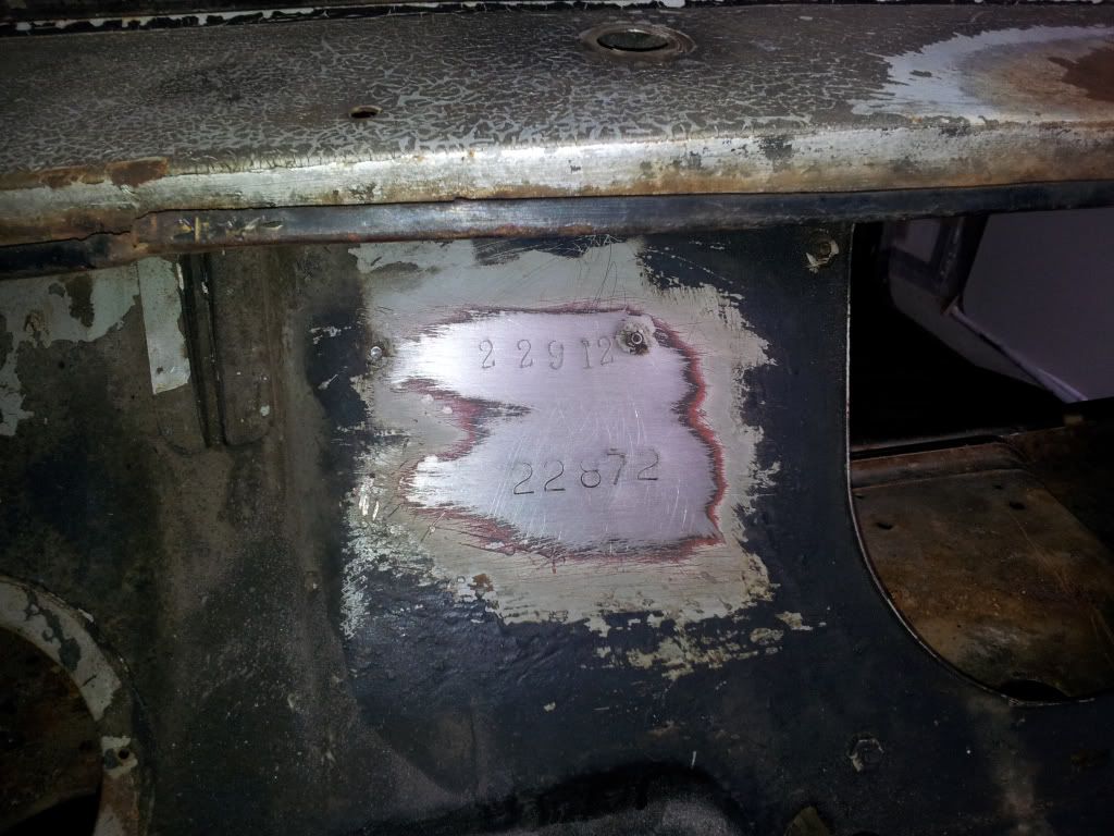

I FOUND ANOTHER NUMBER!!!
So I had a look around today and found another number! It also looks like I have found red paint, this car must have been resprayed and resprayed well.
So why are there two numbers?
PostPosted: Tue Nov 22, 2011 6:31 pm
The red paint is the undercoat.
The top number that was hidden by the ID plate is the body number.
The lower one is the car number, it should match the ID plate.
PostPosted: Tue Nov 22, 2011 6:37 pm
Posts: 677
Bugger. So we are most likely looking at a late 850 in something like English Grey?
