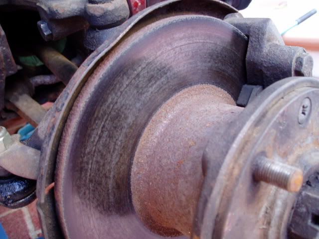

here's a photo of my disc with rust on the edge
thought this was causing the noise....
