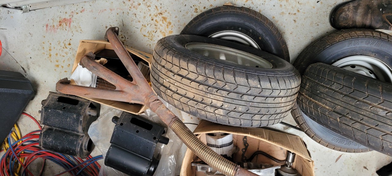

G'day all,
Through a series of fortunate conversations I've acquired a few boxes of Cooper/S parts.
Wondering if these headers are factory S by any chance?
Can't see any markings on them but despite the crappy joins they are in great nick.
Thanks and have a good day

They look like the set that came on my early Mk2 S, the concertina piping looks to be a modification. The lower part of mine had been modified by a PO.

Yours are the genuine pressed metal extractors as fitted to the Cooper, Cooper S and Clubman GT, but the bottom section has been cut off. and flexible exhaust added, unfortunately.

Thanks Clive and Winabbey for the info and pics.
I knew the flex pipe was an addition, I guess they are worth the effort in reworking, they are nice and thick.
I'm not necessarily building a purist level 'S' clone but I do have S carbs to compliment them.

Suggest you get them ceramic coated if you plan to use them on your car. They will last longer.
