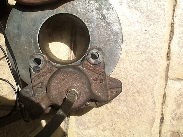

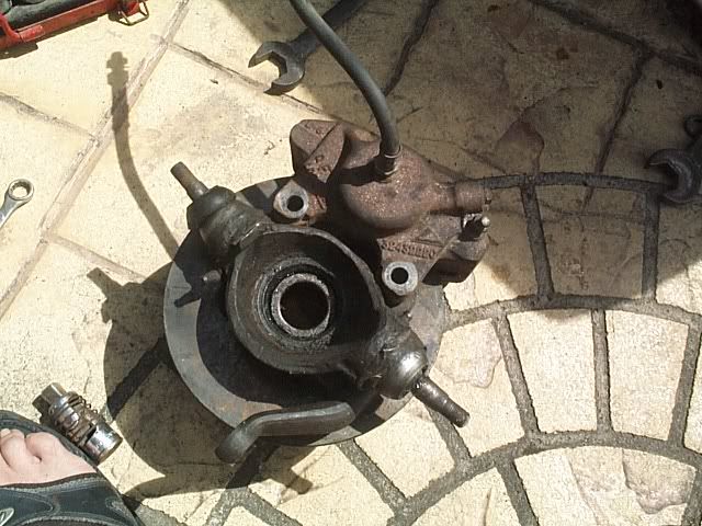

just stripping the 1100 b4 it goes dumpward. and decided to have a good look at the discs.. obviously now i can see why you cant swap the whole assembly, but how hard is it to modify the caliper mounting points?? i set the cooperS hub and disc up in the 1100 caliper and took some pics. if the holes that the caliper mounts by can be filled/plugged and new holes drilled alongside the originals it should fit easily. In the mock up i did the caliper isnt on quite far enough, but the pads are only overhanging the disc by about 4 mm and that would be correctable when repositioning the holes. the caliper housing on the cooper S disc amost fits into a standard 10 inch rim, some slight grinding would be necessary, but in the contessa's there is only one tiny grind needed. .
any thoughts anyone..
what i am proposing doing is moving the mounting holes in the top pic so that the new holes are approximately alongside the existing ones toward the body of the caliper, the difference in distance between the hubs holes and the discs holes is not an issue as its minimal, and would be fixed while redrilling the caliper..

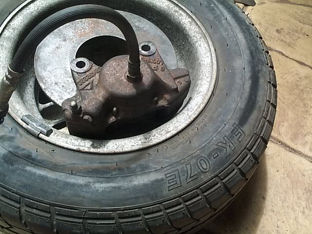

i have had that set up in the pic sitting in both a standard wheel and a contessa's, but its jambing on the sides. as these calipers came with my 1100 they owe me nothing so i might as well have a go and see what happens.. worst scenario is a walk to the rubbish bin LOL.. I still want to hear if anyone has any experience with moving holes in calipers, in particular the technicalities of filling the old holes..

Ok i went back and had a rethink about this , and spent a bit of time with the mike working out the details a bit more accurate, and found out that the new hole will be clear of the existing holeand being as the S hub uses a smaller bolt, the new hole doesnt need to be as big as the original.. the old and new holes will only have about 2mm between them at their nearest point, but i have a cunning plan for that too....
the new hole location is shown in pic 1 , but not quite exact and as mentioned it will be smaller. the outer ends of the casting beyond the original hole will need cutting off, and some surface grinding will be required (can do this at work) also requires a spacer plate between the tapped holes in the hub and the new holes in the calliper (approx 6mm).

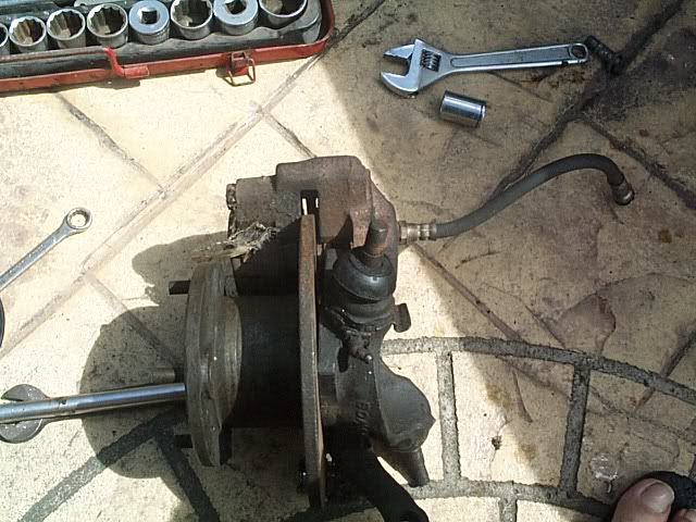

pic 2 shows the unmodified setup sitting fully into a contessa.. it is abut 1.5mm ofset in its unmodified state due to the outer caliper touching the rim. there is easily enough room for a small grind on the inside of the caliper to make 1.5mm difference, and the outside touch point is onlt small so a quick buzz with a grinder there wold make a little extra clearance..
