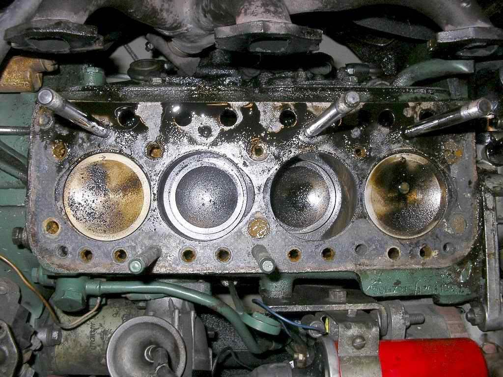

is that suppost to look like that, theres all crap ontop of the pistons ?
Hmmmmm..... Jennifer Garner
PostPosted: Thu Jul 21, 2005 2:07 pm
Normal carbon buildup. Same thing happens inside the heads.
PostPosted: Thu Jul 21, 2005 3:02 pm
Posts: 7673
that looks good.. you'll have to clean all that crap off the block so your gasket seals properly.

Did that with a razorblade. Now running a standard 202 head while the 295 goes to the shop for shave, valves, and a port job 8) .

Compared to many i've seen, those look pretty clean :shock:
PostPosted: Fri Jul 22, 2005 7:50 am
Posts: 39752
And folklore sez it's a good idea NOT to scrape all the carbon off the edges of the piston, as it helps the rings seal....
I dunno if true, but I've seen a few cleaned ones smoke for a while afterwards. :lol:
