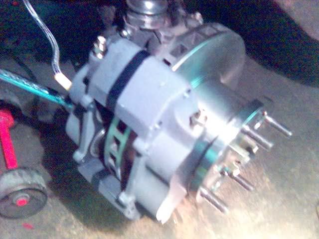

PostPosted: Wed Jul 13, 2005 12:10 pm
Posts: 1753
Location: Leonay nsw
these are the ones from minisport.com.au and they are $895 a pair
these are the minisport billit calipers from the uk which i heard bad things about
these both are for 7.5 cooper s solid discs i think the minispares ones are looking more favourable at the moment but i just got to find a cheap supplier :)
