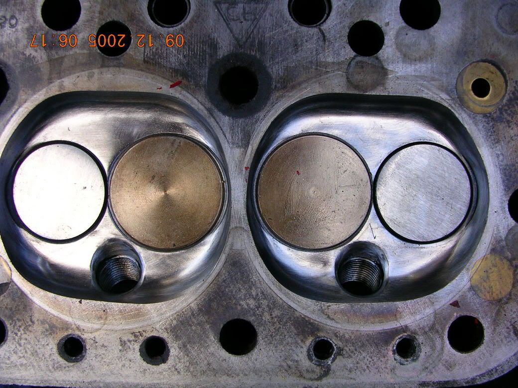

Grant, from your chamber photo it looks like your not running hardened seats for the exhaust.
Are you using a top end lube or additive in the fuel?
How do you find the seat wear?
Cheers Shane
PostPosted: Mon Apr 15, 2013 3:30 pm
Posts: 1170
correct Shane,
I have not run inserts ever to be honest and i run 98 BP, i hav enot pulled then valves out for some time for full inspection but the rocker gaps are still fine.
i do put some flash lube in the tank every 3 or so fills for security.

Those chambers look good....
