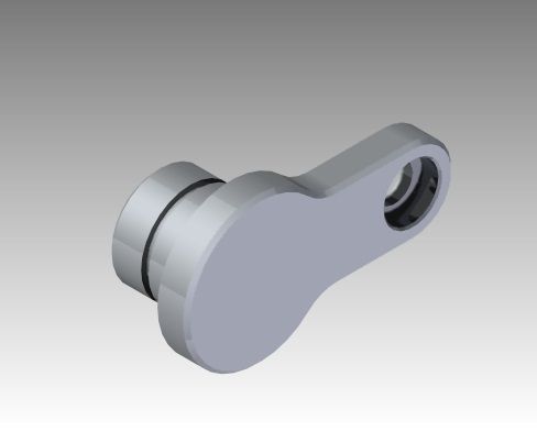

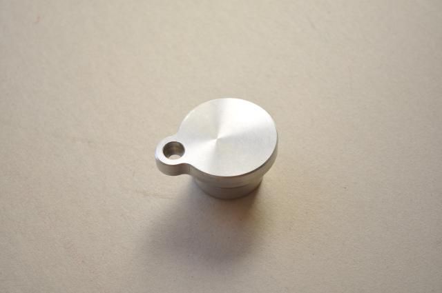

A+ has no adapter is straight in the block.
For a series Plugs the adapter and drive shaft need to be removed and then the plugs fills the larger hole.
For anyone else wondering I have A-series plugs available and will have A+ within the week.
A+ Plug > removes the need for clamp.
A-series Plug>
