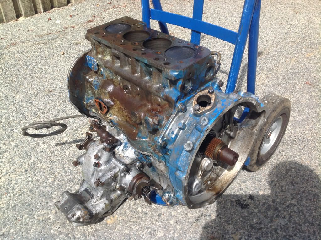

I brought a virgin 1275 A Series engine from Gumtree that's complete minus the head. I've pressure washed this today and drowned it in WD-40. Photo below:

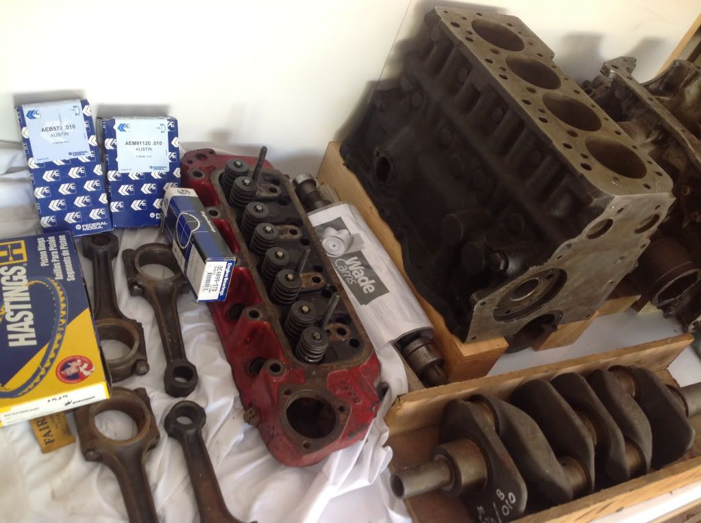

While looking for a suitable head I found one advertised from a metro that needs reconditioning. From the same guy selling the head I ended up buying a another 1275 A Series block that's been bored .06 and just needs to be honed. A Wade reground Cam (#104 Profile (what ever that means!)), a crank that's a 10/10 (no idea what that means either?) a new water pump, a set of various bearings and a gasket kit. He also kindly threw in a used gearbox. I need to buy pistons, cam chain as for the rest I have no idea. Photo below of all the stuff I got today:
So, can the kind folk of Ausmini please provide me a shopping list of what I need and what's best for an engine I want to last rather than HP.

crank looks to be a small journal, the rods are too. The Wade 104 is a nice cam for the road. Looks like the good basis for a 1275. Did you get a 1275 primary gear?
Yeap, it's a small journal (so I was told, what does that mean?) as for primary gear I'm not sure how can I tell?

The virgin engine number is: 12YD/Ta/H15849 & Gearbox: 22A1288 R15842/4

The `virgin' one would have had a big journal crank & rods when new.
Personally I prefer the small journal ones, as the crank & rods are not as heavy.

Isn't the virgin engine )12YDTaH) a Morris 1100S engine so if it's all still orgional it'll have a diff suited for larger wheels, so good for your 12" wheels.

1275 primary gear is on the virgin Morris 1100S engine, clean it up and use it.
The gearbox under it isn't a Morris 1100S by looking at the diff housing. Anyway most 12 inch wheels use low profile tyres, giving the same circumference as a 10 inched wheel.
I agree with the Doc, go the small journal, lighter and stronger rods and the crank is cross drilled.

moot point - it's not an 1100 diff housing, so probably not a 4.1:1 diff... but I hate the look of the rust on the crank tail...
The rust all over isn't as bad as it looks, in saying that is it worth getting the crank cleaned up? Or just finding a replacement?
I'm probably not going to use the virgin engine now as the other parts I brought when I picked up the head seem better. The story with the virgin engine was it appeared on Gumtree cheap, I took it sight unseen as the guy told me it turned. When the guy dropped it over he told me he'd taken it out of a South African Mini 15 years ago filled it with oil and forgotten about it! The outta was covered in dusty/muddy oil! The photo you see was after I scrub the outta coating off, pressure cleaned it and drowned it in WD-40.
If nothing else I can learn just from pulling it apart! In saying that once I have pulled it apart I do instead to get it all chemically cleaned, stored and wrapped to preserve it as best as possible.
