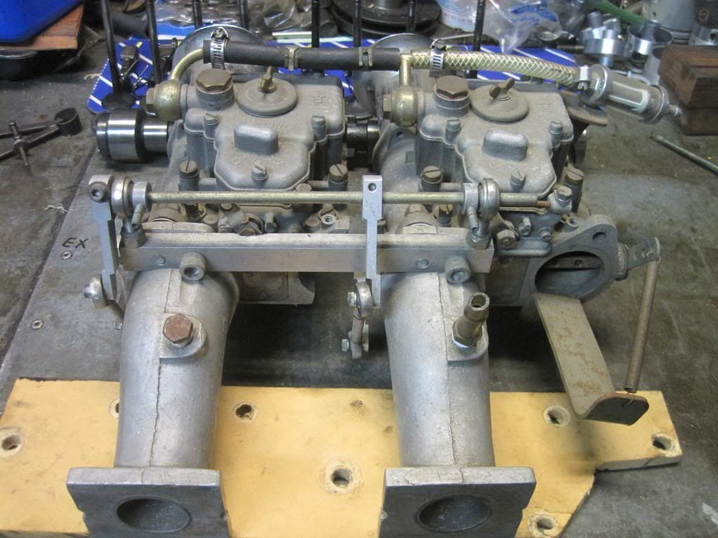

Yes the original use in 1968? was to get around the rules.. the twin SU manifold had to remain, so special tuning acquired (*cough cough*) a standard? pair of Webers which had special flanges to bolt onto it.
Since then, Avonbar and others have made `straight shot' separate manifolds to bolt one and a half (ie a std + a butchered one) Webers on there for racing.

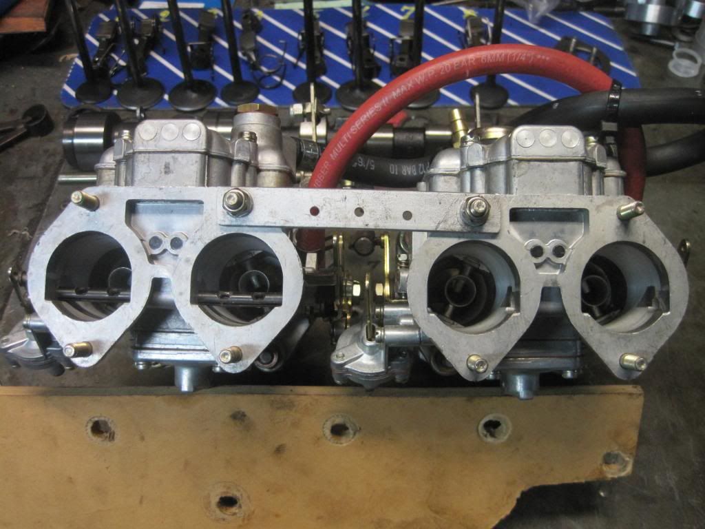

If these don't fit in your car, and cannot be used in Group N. Maybe you could try this setup...
32 DCOF running 22mm chokes
Graham Russell
PostPosted: Thu Feb 28, 2013 11:43 am
Joined: Fri Jan 18, 2013 10:18 am
Posts: 28
Location: Adelaide, Australia
nice set up - what advantage would having twin throttles running into one port have?

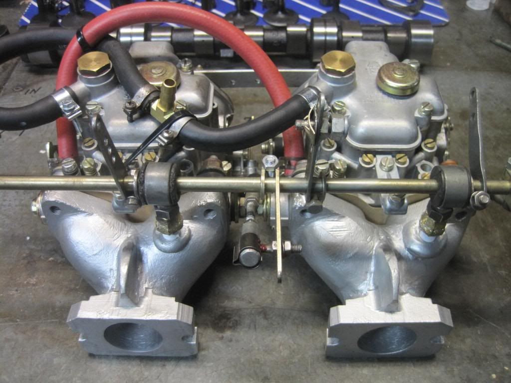

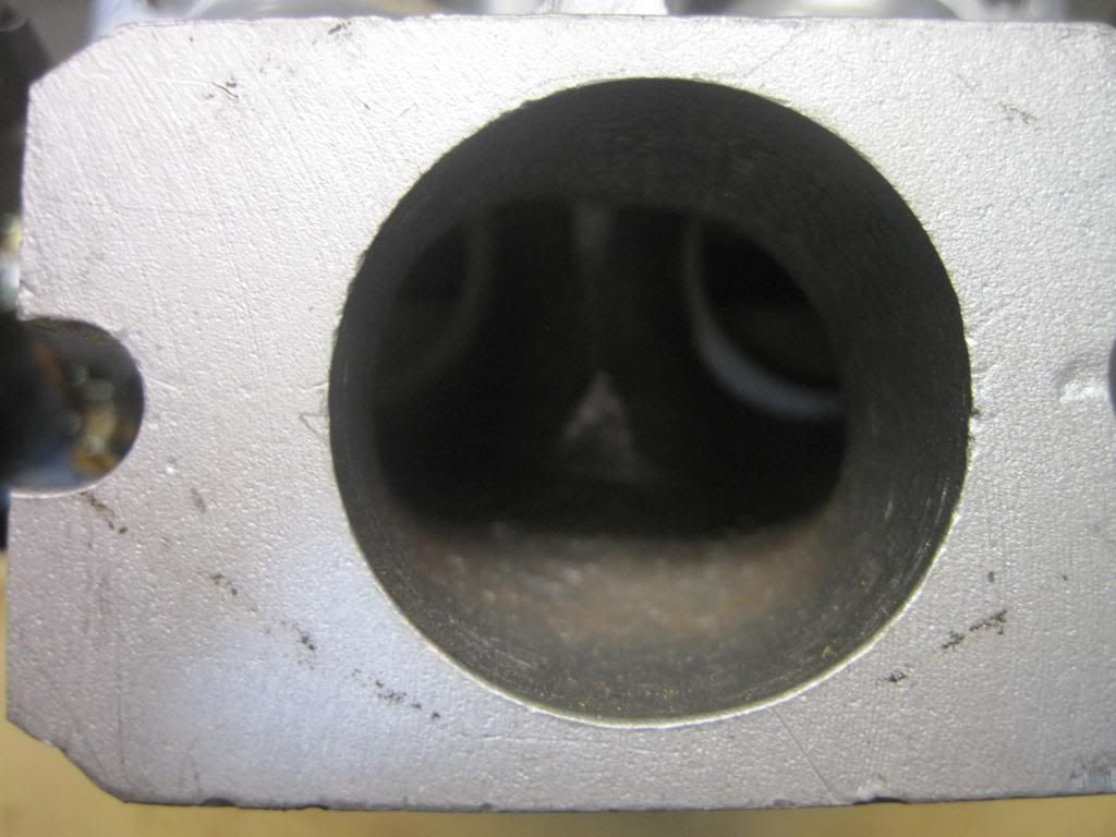

Bill Quine (Manx Racing) did this in reverse to make a 7 port head...
Cheers, Ian
PostPosted: Thu Feb 28, 2013 6:10 pm
Posts: 39752
Bill Quine's work- http://manxminiregister.com/manx-mini-a ... gallery=14
5 port head converted to 7 port- unlike a Pierce 7 port, you can [edit] easily get at the spark plugs with the carbs on!
Not sure how good this setup was for HP- anybody know?
[edit] check the thick bushes in the pushrod holes near the inlet ports...!
