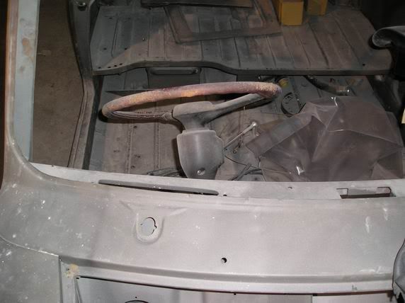

Hey i was looking my mini yesterday arvo and noticed these things that made me worry a little.....
The first pic is looking through the front windscreen, is the steering wheels suposed to be on an angle like that??

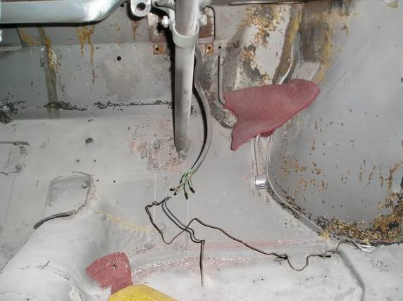

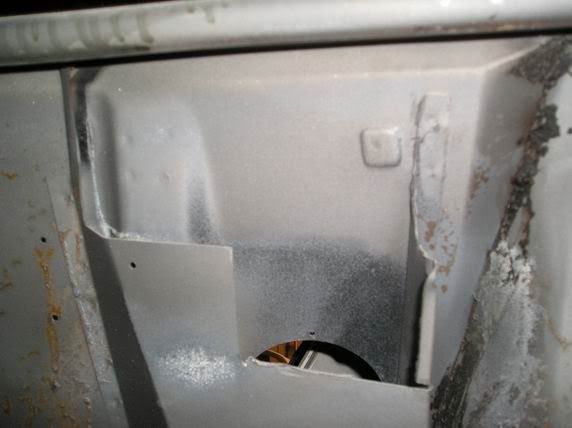

This one is behind the steering wheel in the dash, it looks like has been choped for some unknown reason,
is there anything behind the dash that screws or uses this for anything? Or is there any reason why
someone would have hacked at it liker this??

No the steering wheel should definately not be on that angle :shock:

mmm... There is a brand new steering rack in there too...
What would cause this? A bent steering column or somethin like that?

Sounds like a bent column, though I can't think how someone would bend it short of a prang

doesnt that thing just vent to the windscreen? and yup, that column is bent!!

I'd take out the Colum and role it on the ground and and see if it is bent.
Possible the the rack is not positioned properly (don't know how :shock: )
that is only a vent :?: warm air to the wind screnn..Once again I don't know why it like that :?:
PostPosted: Tue Jun 07, 2005 8:05 pm
Before you do anything about the steering column..... Think!
Have you ever looked at another mini from the same angle?
Well you should! because they are all like that! :lol:

just position a 4WD on the passengers side of the car... attach strong rope or chain to top of steering column and gently pull.. :)
kidding.. looks like it has to come out Gordo ;) bugger eh

Morris 1100 you are correct :shock:
The wife's Daily drive Morris is also the same :!: I just checked :wink:
If it was straight it wouldn't go between the brake and the clutch pedals! :wink:
Your feet are angled to the left because of the front wheel and the column is also angled to the left.
You should look at an XU1 Torana (or any LC/LJ) the steering column aims one way and the pedals aim the other. :shock:
PostPosted: Tue Jun 07, 2005 9:04 pm
Posts: 1461
So its meant to be like that.....??
I looked at it and it didnt look right so i thought id ask, and without the clutch and
brake pedals there i had nothing to see why it would be like that.

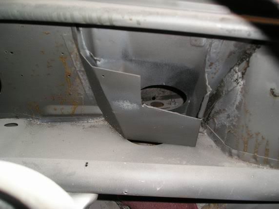

And the other thing is for the vent.. I dont think im even going to put the heater
back in, i think its a waste of space..
The hole behind the vent thingy had a plate screwed over it when i got the car,
is this hole used for anything?

PostPosted: Tue Jun 07, 2005 9:14 pm
It is used when the car has the fresh air heater mounted under the bonnet. So most cars have the plate screwed in place.
PostPosted: Tue Jun 07, 2005 9:19 pm
Posts: 1461
So if i cover that hole up, and by cover i mean weld it up, nothing is meant to go
through it?

Ok my idea is that the steering isn't bad it is just the angle of the piccy because the windscreen isn't dead parallel as in flat so it makes it look as if it is bent but it isn't
my 2cents worth anyway.
