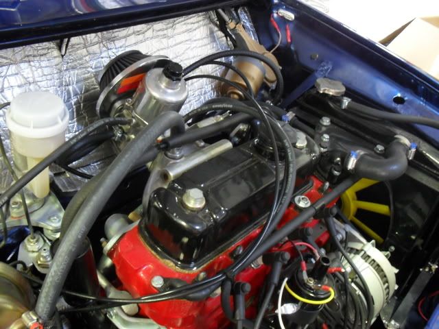

'ITS HERE! ITS HERE! ITS HERE!
Am i excited HELL YES
nice new shiny block ready to assemble
Graham Russel flat tops ready for rings
[/img]

PostPosted: Wed Oct 10, 2012 4:52 pm
Posts: 1550
Ah, so it's red... well that answers that question :lol: Glad to see you finally got it back though... Took them long enough!

very happy with the work and service. The wife picked the color for the engine and we had a good look at paint colors for the body to match, She made a choice but as we all know Women change their minds OFTEN.
I have to wait a few weeks for funds so i can get a few things i forgot to pick up. ie: big end bearings and rod bearings and welsh plugs i need to assemble it. Its ok with me that means i have time to concentrate on rebuilding the front subframe, suspension and install the cooper s disks
being a holden man at heart it had to be Holden Rocket Red.. i did give the wife 2 red options this one and Chevy Orange :lol:
