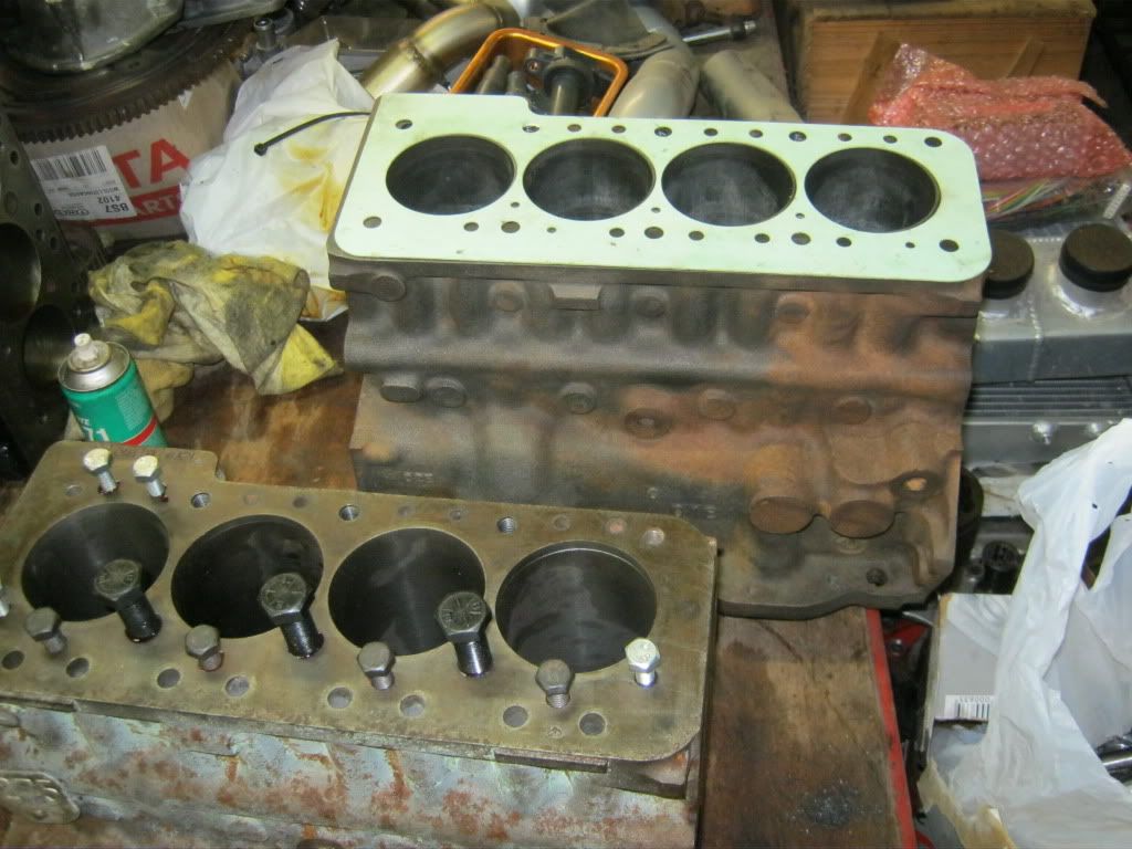

why does the block have bolts sticking out of it in the main picture
is it to block off the holes for your K1100 conversion
Also did you ever finish your build guide you where writing
Kiwiinwgtn
PostPosted: Sat Mar 10, 2012 9:37 pm
hee hee,,, yes we tap threads into quite a few of the water gallery holes & old mini head-stud holes & bolt the bolts in tight with some loctite,,, let the loctite go off & then cut the bolts off as flush to the deck as we can,,, & then we fit a couple of cast-iron bungs into 2x of the mini head stud holes (the end ones) as the new Bimmer head stud locations interfere with them & the after the block-face has been skimmed/decked we then mark all the relevant Bimmer head stud & water gallery locations & drill & tap as necessary

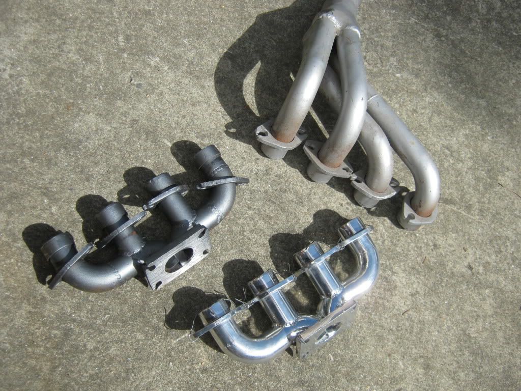

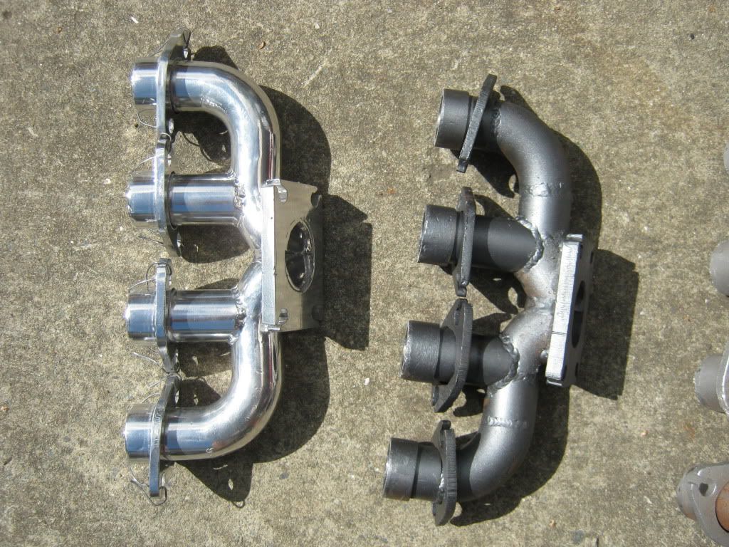

PostPosted: Mon Apr 30, 2012 3:54 pm
bit more Twinky stuff happening lately
had some more Turbo manifolds made & Jet-Hot Coated (The spiffy one is for Ian on the Moke forum)
getting one of these Turbo charged twinky donks to fit inside the engine bay with all the associated ancillaries makes for not very much room left
we took a gamble on this one & bought a Renault-5 alloy intercooler & tried to make it work but it`s just way too big,,, it looked good on paper (Maybe a tad on the tight side) but it`s just way to much happening under the bonnet to fit the thing,,, the last one we used was a ford/mazda 323 type & worked pretty well , although it wasn`t the pretty-est so i thought the Renault one would sweet things up under there, ah well,
sooooo,,,, as much as it may "look" like there`s only a few hoses to hook up,,, i`m sorry to say that there is still a ways to go before this one fires up
i`ll have another intercooler made next week (this time to make it actually fit) & then get back onto fitting the throttle body & hoses etc ... & then we can finish up some breathers & oil drains , wire it up & fire it up after that
