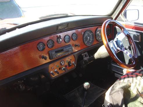

Hey a guy in Sydney already has the Jag dash idea covered in a Clubbie. Nice alternative to switches and stuff I must admit and finished off perfectly..
PostPosted: Thu Jun 09, 2005 5:56 pm
Not my cuppa but its a fair effort.
