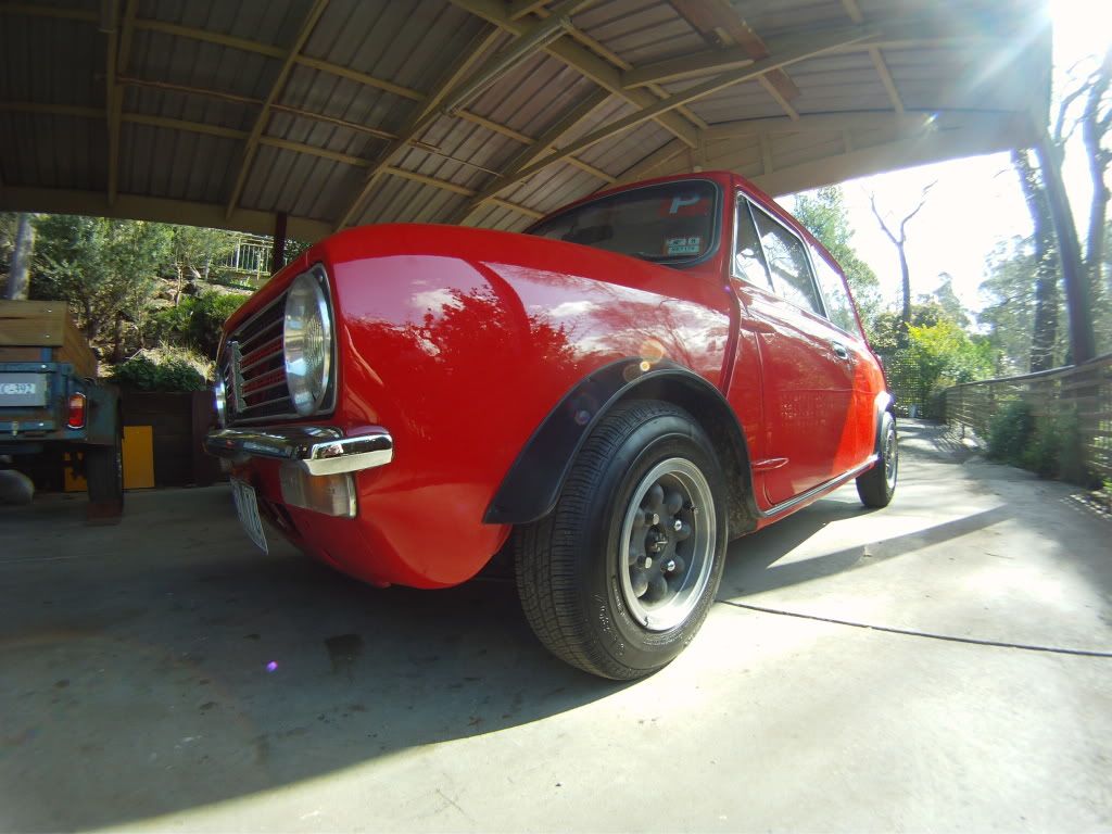

Well, went down to link on Wednesday and had the car looked over and the sus. pumped up. rides like a marshmallow now! (well, compared to what it was :lol: )
This is how she sits now. Much better stance.
PostPosted: Thu Sep 15, 2011 2:00 pm
Posts: 39752
These displacers are all 40+ years old now, damping of the system can be improved by fitting a pair of standard shocks to the front.
The holes for the shock brackets are there already, just go rob some brackets off an unsuspecting Clubby. Details how to fit are in the `how-to' forum.
As for the rear, mine handles lots better with a rear hydro competition bumpstop kit. (I dislike using these on the front as the car sits too high).
The combination of these 2 mods gets rid of the hydro's sometimes diagonal lurch into corners, and most of the fore and aft rocking under power and braking. IMO it outhandles dry cars on the goat tracks we call roads. 8)
