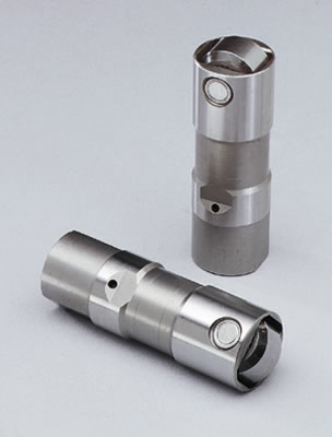

Are roller cam followers available for Minis?
Just as you'd see in a high RPM V8?

I doubt it. The shape of the Lobes used for Roller Followers is quite different to that for flat tappet type (like those in the A series). I think a few have played around with trying roller followers but effort / advantage doesn't tallyup too well. They are also heavier than a flat tappet and so your valve springs and possibly push rods need a serious review.

We have been through all this before... yes, it has been tried- there is just not enough room in there to get decent performance cam profiles and lift with a roller cam.

A good friend races a pair of Aermacchi classic motorbikes and keeps wearing out cams every-other race meet or thereabouts and was on the hunt for more reliability, and maybe some extra horsepower.
He's only got about 3/4" to machine in the barrel for something to fit, most V8 stuff whilst easy to obtain is too large.
