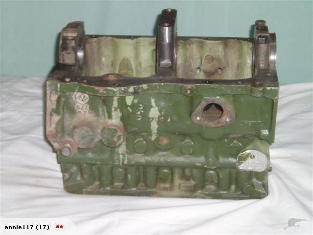

Block has been bored and decked(alot) 74.7mm and the pistons come up close to flush in the bores :D
:D 1426cc :D
also came with a nice 010 under crank.
And, the guy i bought it off turned out to be an old family friend (great guy) and gave me a grille and bumper for my ELF, so im a happy chappy 8)

not much meat left between them holes :shock: what head mods are you planning?
PostPosted: Thu Aug 16, 2007 7:39 pm
Posts: 1943
not sure yet, it wont be in the car for some time, car is only half built, and will get a 998 untill i sort brakes, im going to need fairly big chambers though :lol:

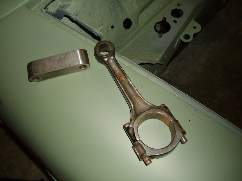

What rods would you use with those Triumph pistons?
PostPosted: Fri Aug 17, 2007 5:58 pm
Posts: 1943
stock(in a way) 1275 rods, they are releved of some weight and polished however. the look cool 8)
PostPosted: Fri Aug 17, 2007 6:30 pm
Posts: 1943
a rod and a centre main strap.
