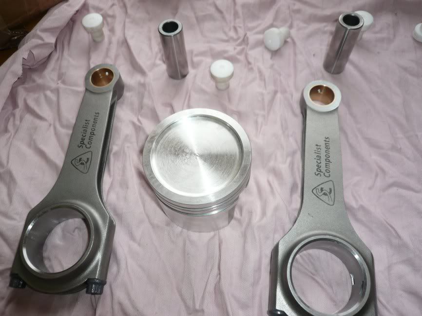

What's the advantage, if any, of H beam con rods for a road engine? The ones I'm looking at weigh 490g each and are balanced end to end within 1g
PostPosted: Fri Oct 23, 2009 2:05 pm
Is it a 9000 rpm road motor?
If the answer to that is "No", then none.

Why H beams not I beams? I'm thinking purely in an ultimate power situation here...
This is me thinking out loud, but, halfway down the power stroke when the rods at say 20 degrees the I would be bending about the major axis and would therefore be stronger, whereas the H would be bending about the minor axis. The + as shown in the picture above is just inefficient as it doesn't optimise the material placement well at all.
This makes me think that the I beam rod is more effecient in terms of weight and that the ultimate rod would be tubular, although very difficult to manufacture.
Well at least thats the way I see it anyway, are there other reasons for using H rods that I am overlooking, or am I just completely wrong?
It can be hard to identify stress concentrations but the H does look like it may have the advantage at the point where the beam merges into the main cap, is this more likely to be the reason for there shape?

albino - as you said in your posting "I'm thinking purely in an ultimate power situation here... ".
It's fine to think that way, but most of us with A-series engines are looking for 1) light weight rods and 2) failure proof rods when used in our "less than ultimate power" engines.
My vintage racing Mini is nowhere near the "ultimate power situation", but the rods I run weigh only 439 grams with the special ARP bolts. I also got them for a price that is cheaper than what lightened and prepared Rover rods cost. So, mine are: much lighter, stronger and cheaper. It works for me.
The rods in your photo(with the plus '+' sign) look like those made by a California firm named Pauter Machine. Here are some sample weights for their rods.
http://www.pauter.com/exotica.htm
