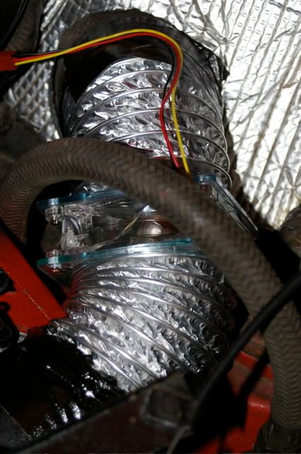

80mm mylar ducting with spring steel ribbing, and flanges either end to accept standard 80mm 12V PC case fans. There's an idea..
So, I bought two lengths, removed the flanges from one end and sandwiched a high-capacity 80mm case fan between the two ducts. A $5 variable-speed fan controller and a toggle switch completed the setup, now I've got variable fan-assisted heating / fresh air 8) 8)

I never thought it'd happen, but I've had to turn the fan down a few times because the car was getting too hot :lol:

I got mine from coolpc.com.au, $19 ea (I used two). It's important to note that it's not quite 80mm in diameter, more like 78mm.. which means it won't fit over the heater outlet or inlet. It's a pretty neat fit inside though, so I just used a little gaffa tape to seal it.
