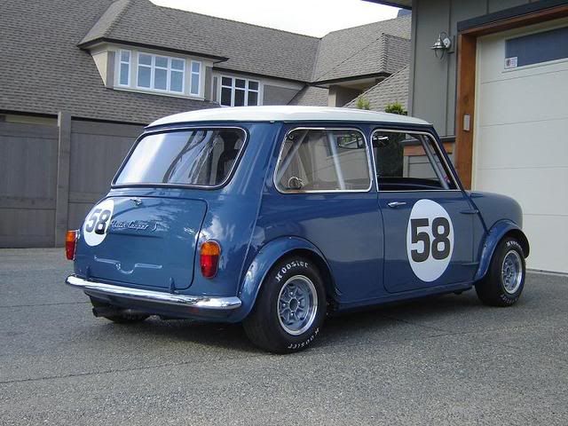

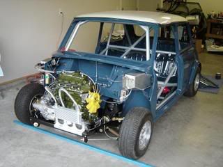

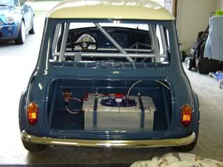

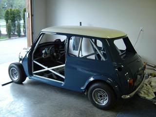

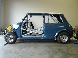

Friend from Canada sent some pics of race car he was helping build, bit different to our Oz race cars . . .
Steve

looks pretty nice, can the images get a little bigger? I'd love to take a closer look..
have to agree looks great but a little hard to see :shock:

I'll have another go with pics a bit bigger, what is the best size?

around 640x480's nice :wink:

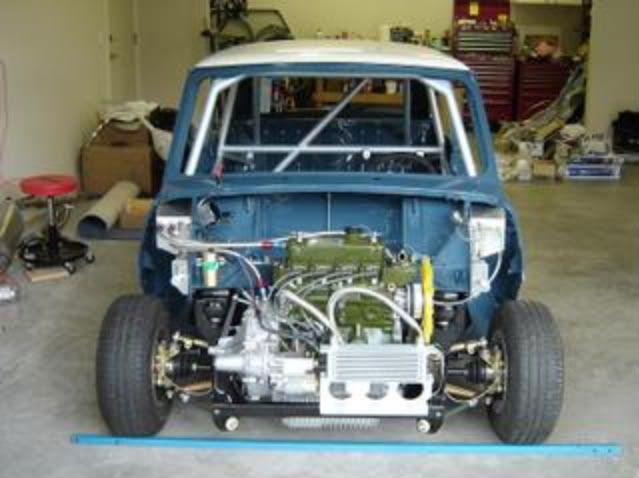

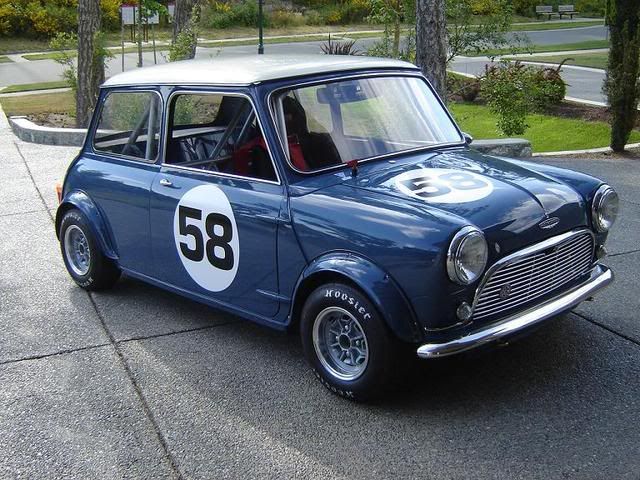

Motor uses 1300 block (no tappet chest covers) with a 1300 crank, A+ rods with ARP bolts, Mini Spares Mega pistons +.040, center main strap, VP4 cam (not a scatter), 12:1 compression, ported head that seems to work well, Swiftune dog box with JKD plate LSD and 4.05 FD.
Been talking with him to run GR's race cam. I'll ask him for an update once they run it.
Steve

No troubles Steve...I just wanted a closer look and found they were bigger on your bucket.
Man thats a High Compression :shock: and I agree he should try the RE13 cam and see if he likes it :wink:

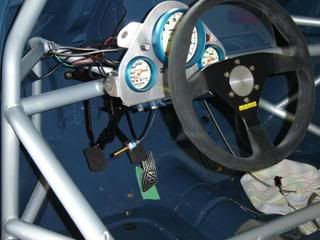

Can you see if you can get a closer pic of the wheels also please 8)
They look like D1's but not :lol:

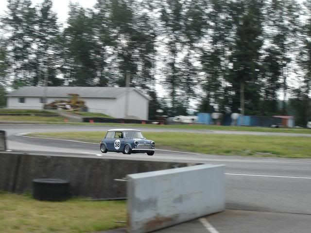

Update on this race mini -
its first race outing -
Steve

13 row cooler why isnt he running with a bigger oil cooler?
Maybe because their ambient temperature is much lower than ours, this time of year they get snow, and plenty of it. :)
