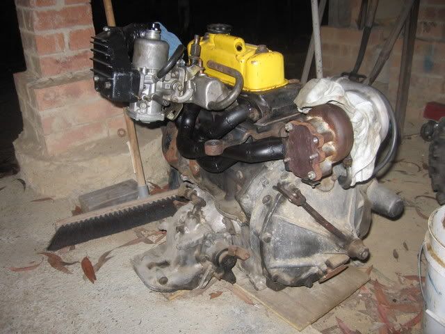

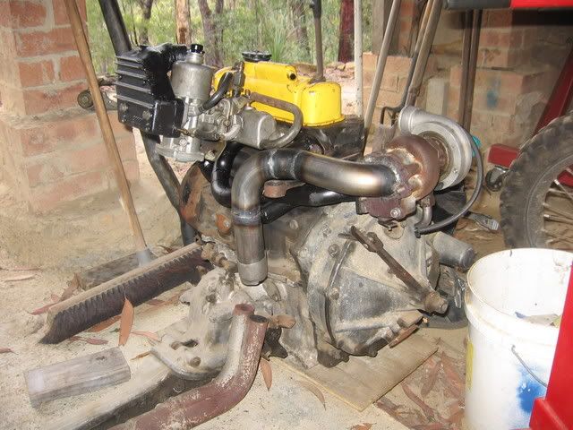

well peter (pristic) was building his hot 1132 around the same time i finished my turbo conversion. when it originally went on the dyno he was impressed but still wanted a 8port as he wanted around the 140hp mark.
after changing a few things (see my thread http://www.ausmini.com/forums/viewtopic ... highlight= ) i managed to get 140 hp with mine , without the cost of a 8port head. Quikly peter was very interested and i convinced him to build an all out 998 turbo. The plan was 20psi boost plus the same turbo as me but over the clutch and an expected output of hopfully 160ish flywheel hp.
So peter organised the bits while i did his turbo setup ( manifold dump pipe and turbo fitings). Iv been doing it for a couple of months now in between other things.
Peter is now starting to get impatient and has dicided to swap cams in his 1132 and run the setup on that with low boost while he is building his 998.
anyway ill update things as there done :wink:

That's a nice neat looking setup , I'll be watching this thread to see how it all goes .

Hahah, we'll see how she goes at the runs one night... but should be fun :D

Pfft, she's a sleeper... ;) Wont know anything from the outside... hehe
Just like Ben... looks like a nice little mini...
Peter.
