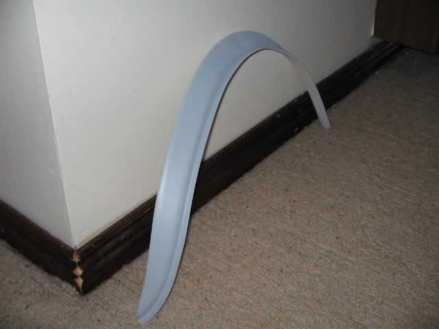

sorry i havent replyed been busy doing things over the weekend, these are the type of flares i have so i dont know wat they are called

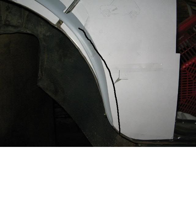

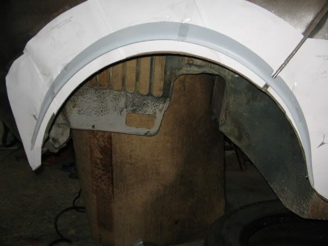

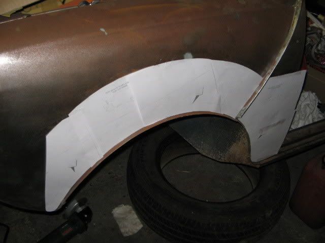

i downloaded the templates and put them on the car to get an idea how much i have to cut off
then i put the flare on (held by sticky tape)and tried to get it into the shape of where it should be, but on the a pannel i couldnt get it to shape the out line on the paper
has anyone help problems when cutting the arches bigger like this, i have drawn where the line is because my printer is very low on ink

The printed template does not suit your arches, plain and simple.
Yours would be "Cooper S" or maybe "LS" or possibly "Group 2" arches, which are meant to suit an unmodified guard.
I would suggest fitting all the running gear to the car first, sit the car at the desired height, turn the wheels lock to lock so that you can find the fouling points, mark the guards to clear those fouling points, then offer up the arches to see if they suit/cover the required modification.
No point doing the arch modification until you know how much you REALLY need to have removed.
*edit - it also seems that your arches have compressed a little bit, as the curve seems a bit pointed towards the top. The front edge needs to be pulled closer to the bumper bar, which will flatten out the top of the arch, making the curve a bit more even.
As a point of interest, the template cut outs are still not quite enough for 13x7 wheels on a lowered mini. Even 13x6's can still possibly rub (in areas forward of the centre point). Aim to have around 40mm removed mainly from the TDC of the arch forwards, leaving it so that any part of the panel rear of TDC is unmodified. This should be adequate. There will be no fouling issue for the rear half of the standard wheel arch, even with 13x7's.

yeah those look like clubby S flares, you need the lip to mount them, which you will have to cut a lot of it off for the 13" wheels.
i recommend getting screw on flares, there are types that screw on and also have a lip built in for the chrome strip.
the alternative would be to create a new lip after you had cut the guards.

your going to have to buy sportspack arches or group 5 arches (there are other types aswell) the arches you have are ls/cooper arches and your wheels are still going to stick out heaps, so it wont be legal.
also your going to have to cut your front gaurds, so those flares wont fit afterwords either.
those arches will suit 12x5 superlites with disc brakes fitted and also 10's with the correct offset ie. cooper wheels
they will also work with 13x5
