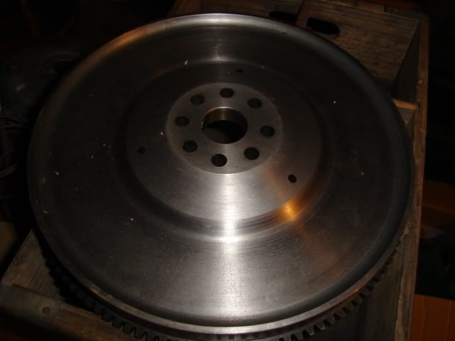

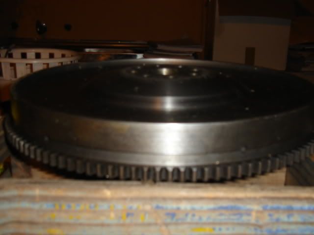

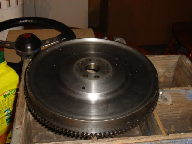

Yes it allows the engine to rev out quicker since you have removed mass and it should rotate quicker(I think). However the downside is you lose some low down torque but it is negligible. I have a lightened one in the new engine and it is much of a muchness(static it revs better under load however the dyno showed a little drop in the low torque - you just have to get it there with gearing and changing them higher up the rev range)
I just recently changed the flywheel on the Soob and they tooK a massive 2.6kg out of it. Revs its tits off now but I have noticed a little loss in low range torque when I am traversing the dirty stuff but it gets up to operating revs quicker. It is a compromise I suppose.
Heres a pic of the Soob Flywheel - consider that the original is completely flat from the edge to the centre: They took it off the engine side only and it took them 3 hours just to mill it down(hard stuff this...lol):
Not real good pics but you get the idea

PostPosted: Sun Jun 10, 2007 12:29 pm
Posts: 2360
Location: SE QLD
LS1380 wrote:
Bubbacluby wrote:
whats the advantage of a lightened flywheel - does it only help you get the revs up better??
Do they lose horse power - like a heavy one when it starts moving takes a lot to stop can have more restriction and still turning, where as a light one wont?
Do they have any disadvantages??
It revs hard :shock:
BLOODY HELL!!!!
Nice looking gear there. Do your revs drop off quicker with that setup? I noticed the Touring Wagon goes up quickly to revs but drops back even quicker now...
Again nice gear...
