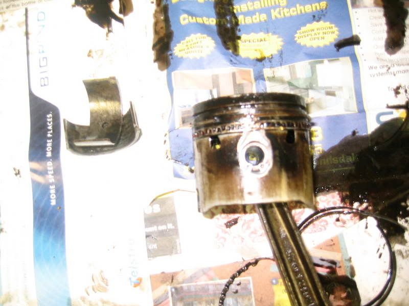

I pulled all my pistons out and they are all melty around the gugeon pin.Image
I know that the main bearing caps have to be in the correct position and are not interchangable, does the same apply to the con rods?

Yes, keep the rods and caps in the same order that they came out and put the caps on the end of the rod in the right orientation. Mark them with a centre punch if necessary (1 dimples on rod 1 and 1 on the cap adjacent, 2 dimples on rod 2 and 1 on the cap adjacent, etc. is how I usually do it)
Hijack: What type of pistons are those? I pulled similar ones out of my 1100 and I was thinking of just honing the cylinders if I could get away with it and putting them back in, but they have broken rings and I decided to not be cheap. In Vizards book he comments on a similar piston which also has a ring below the gudgeon pin and says that the crown can separate from that type of piston if you give it a hard time. I assume this one would be the same because of the large oil drain holes?

Yeah I just reringed a 1098 + 60 and it uses oil. Not sure if it is the rings or the head though. It was only a cheapo rebuild so I'm not concerned. I've pulled a few engines down with pistons that look like that. The wear almost looks like the bores aren't round :? I pulled one out of an engine that was like that all the way up to the top and has siezed the rings in. That engine did run, but boy was it smokey!!

With time, the bores not only wear oval, but tapered too. The best reason to rebore it, and fit new oversize pistons to suit.
Fitting new rings alone to an A series is false economy.
