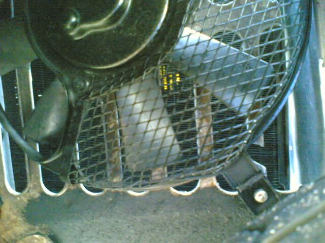

A: For the $200 you would spend on the pump + $100 for the controller you could buy a new thermo fan and a new heavy duty radiator, giving you far better cooling & reliability, with a greater increase in power (due to the parasitic loss of the mechanical fan).
Unless you are planning on a boot mounted radiator, just get a small thermo fan with shroud ex-Pulsar, Swift, etc, for $15 - $25. Mount it under the guard neatly out of the way. Bonus is you can lose the radiator shroud - it really makes the engine bay neater & far easier to work with.

You need the thermo fan and shroud off the donor car,
then dispense with the standard mini shroud. Most thermo fans are suck through, not blow through.

You won't need the mechanical fan shroud but you should try to seal the gap between the radiator and inner guard as much as possible. This encouranges air coming in through the grille to go out through the rad, not around it. Obviously, lots of the air goes under the car because the bottom of the engine bay isn't sealed.
Note that the electric fan is for low speed and idling. Once the car is up to speed, the forced air flow from moving is more than the fan could do with its little motor.
Also, choose an electric fan with a small diameter motor. Some have short fan blades and a big arese motor in the middle. The motor will just block a large part of the rad if the fan is close coupled.

With the removal of the radiator shroud, how did you mount the radiator without it getting all messed up from the vibrations? From the pic It looks like that you have made up a new "shroud" and welded it to the body?

I just got some shiny aluminium, folded it & riveted/sikaflexed it in place.
The Sikaflex seals everything & stops any rattles, and is probably stronger than the rivets!
Note: I do not recommend removing the metalwork from the body (it was already done on this car), just remove the screw on shroud from the engine side of the radiator.

cheers. I run a electric fan on my radiator, and i recently put a shroud around the radiator to stop it from rattling around, i found that it made cooling A LOT worse, simply because it screwed up the air flow. I think i will just get rid of it.
