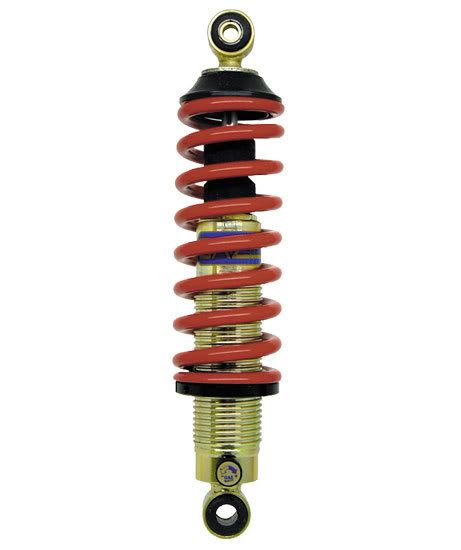

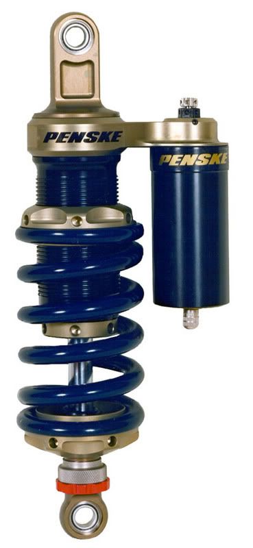

The coil-over shock units I'm referring to are like this:
GAZ
Penske
There are a few sizes of spring but they are common across many manufacturers. Springs are available in 2" length increments from 5" to 14" and 25 pound increments from about 200 pound (pounds per inch rate) to 1000 pound. Shock units have spring seats on height adjustable platforms for corner weighting and ride height adjustment.
Manufacturers include:
Kemppi, GAZ, SPAX, Penske, Eibach, Koni, Bilstein, Whiteline, Tein, AVO, Lovells, Ohlins and Moton.
So you see there are very many options available to select the right rate and damping. It is the installation and required reinforcement I have reservations about (and the cost).

The cost varies hugely. These devices are quite universal and can be had for about $300 a corner. The Penske ones above could be over $2500 per corner plus springs, easily.
