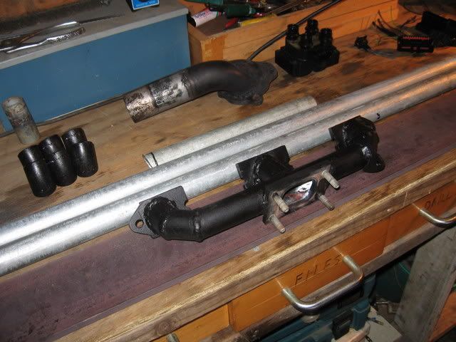

while the engine is out i will be giving it s freshen up. the first thing will be the manifold , a new design is on the way just to help a little with flow , as the old one posibly lacked in this area. The new manifold will also be ceramic coated and skimmed after welding, because this was not done last time the centre exhaust flange developed a leak.
old manifold->

anyway here are some pics of the maniolfd taking shape using my NEW Tig welder :)

Boy that manifold sure looks like it would creat a massive amount of back preasure even for a turbo motor... Espesially form the 1 and 4 cylinders.. Why dont you use a standard mini header system..?

Neat welds on the start of the new manifold... can't wait to see what it turns out like 8)

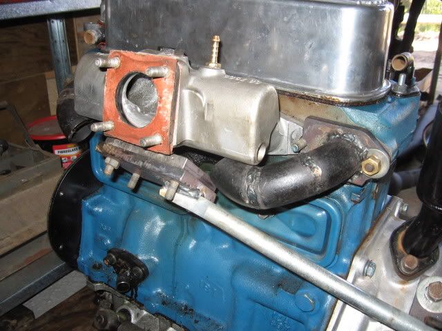

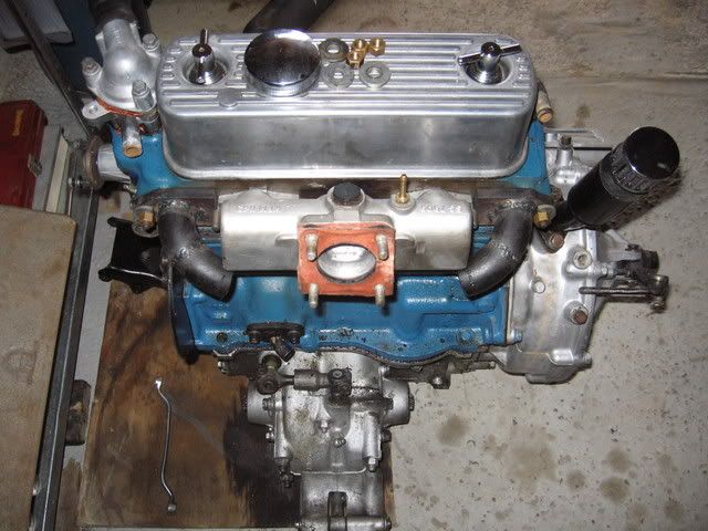

got a bit more done on the manifold , made a jig from te othere manifold so that the turbo stays in the exact position so exhuast can stay the same (saves me makin a new one) and because the turbo fit without any firewall mods.
A std mini header is totally the wrong shape to fit the turbo down the back of the block and you would deffinatly need to modify ther firewall in some way , extractors could be modifyed to work but most are made of thin material and could crack with the extra heat and weight of the turbo.

here some photos of of today not much room to play with when you want it to fit without touching the firewall

Top work ben! i can see good improvements from the new mani. Would be nice to get the boost on a bit earlier :) great effort 8)
