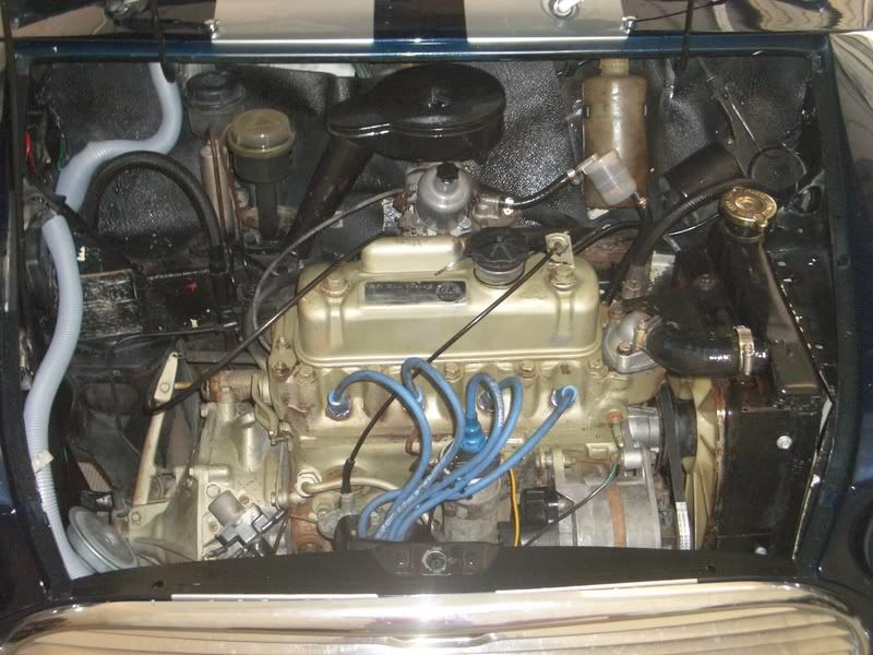

I'm on the fix up wagon again and was looking at changing my air filter setup. I've got the stock filter at the moment
Image[/img]

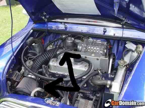

But was wondering what was needed to do something like this (without the supercharger)
I was told that the commercial kits dont have the attachmets needed for a mini. can anybody help me out
OR
Something like this (its supposed to be a chrome filter cover)
I know hi-flow make one but are there any other brands/options out there?
ANY HELP WILL BE MUCH APPRECIATED!

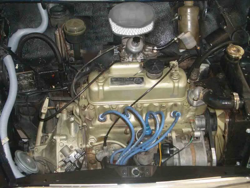

These are my air filters:
PostPosted: Thu Dec 28, 2006 10:20 am
Joined: Tue Jun 21, 2005 9:14 pm
Posts: 246
Location: Enoggera, Brisbane
Thanks 1018 the pic was a great help, yes I think that actually looks better than the cone. the reason I was looking at the cone option at the front of the car was not so much the ricer option but the fact that your getting cold air induction. (however warm it is in QLD). thanks for all your input everyone!
