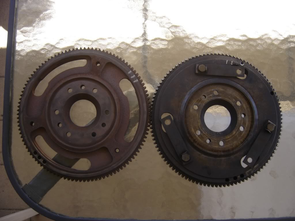

The nut on the First Motion Shaft came loose,causing some damage.
Have had to replace Mainshaft and 1st Motion shaft,plus bearings and bulkring.
Fitting "bling" flywheel and driveplate with the re-build. :D

Those ultra light flywheels are too light for road use, IMO.
We are sending Cody's brand new one back because:
1. it has .050" lateral runout where they had welded the ring gear on
2. it is way out of balance
3. it goes so far onto the (good) crank nose that it would need machining inside to clear the C-washer on crank.
The steel road ones are a better bet, they run true, but man they are expensive as the one above.
I lightened a stock one instead, it fitted fine no problems. 8)

You'll find it needs more revs to get away, that's all. And it is bound to run a bit rougher down low.:wink:

Hope they didn't warp the flywheel when welding the ring gear on, like MiniSpares did with Cody's... :shock:
