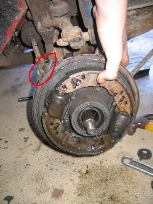

i installed all new slave cylinders and pads on my 75 clubby recently but on the front left drum there is no springs holding the shoes together i asked another person with a clubby and they said theres didnt have any on the left either
it might be a bit stupid but... yeh where there supposed to be springs on the left side
it pulls to the left and i think this might be why
any help would be good cause i cant drive my car until im sure
if there was supposed too be springs holding it does any one have any?

Yes there are 2 main springs on each side, and a spring thingy attaching each shoe to the pistons.

Picture version of what Dr Mini said.
Stolen from the ball joint thread -
No more Minis!......For now.

yeh it has the little springs holding the shoes to the cylinders but no long ones.
its a mistery why they arent there?it was an old ladys car and only had 55000 kays when i got it new
and i dont think she did services at home
PostPosted: Mon Feb 13, 2006 7:40 pm
Posts: 39752
Those 2 big springs not only contract the shoes after use... they ensure the shoes are held square against the backplate.
It is dangerous to run without them- the shoes will rub on the drum all the time and overheat. They will also tend to wear crooked. :cry:

the front left pads whers worn too crap house so i geuss your right
