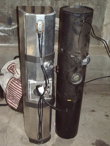

You can make a bigger capacity tank to fit in the standard bay if you have a late Moke. My new alloy tank holds 46 litres, up from about 30 for the standard cylindrical tank. Here's a pic, the big hole is for the in-tank EFI pump so I can inject my Moke :

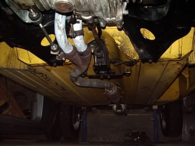

LCB = Long Centre Branch. Extractors where the 2-3 cylinder pipe joins with the 1-4 'Y' pipe under the floor instead of behind the engine.
Careful what you buy. Moke rod change mechanisms are closer to the engine than a mini and some extractors point right at the rod change unit in a Moke. Could be a pain to install if you get the wrong one. This is my '82 Moke's exhaust. Earlier Mokes have the rod change closer to the centre of the tunnel.

Had a look at my underbody- looks same as yours for the rod change mech (now I know what that 'thingy' is too!). Exhaust dude says he's only got Wildcats- are they worth getting on in place of the LCB's? :?

Mokesta - you make me wish I'd made my tank bigger 8)
PostPosted: Tue Nov 22, 2005 4:38 pm
Posts: 2495
Location: Vegus, Brisvegus
Mack, I made the tank myself using a sheet of alloy I went halves on with a mate. I can send a drawing if you give me an email address. The tank has two baffels and uses 3/8" tubes for cross feed. I got some bloke my mate knew to do the welding. Total cost including alloy, folding, adhesive foam and welding was just over $300.
