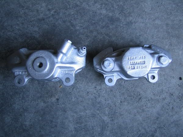

Story to date: Months ago I went against very good advice and purchased as second hand set of Cooper S discs and have been buying replacement parts since then :( If you are considering this, my advice is DON'T! Just buy a new set! cost so far has only been a few $100 off buying a brand new set...
Fast forward to last weekend, Dr Mini helped me rebuild the calipers with new kits, new pistons, new seals. Back brake cylinders changed to S ones, new brake lines at the back, hubs have new bearings, 4 new ball joints, brand new CVs, boots, etc.

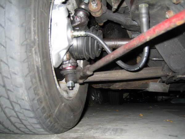

This weekend I dismantled everything, changed the left brake hose which was a piece of cake, but the right hand one was challenging to say the least! :shock: What a crappy place to put the brake hose bolt! Why have a hole cut on the left hand side but not the right? So needless to say I "redesigned" a new hole in the right hand gaurd to get to the bolt and brake switch. Even then it was a bugger so I had to remove the matic heater as well.
Anyway all in the past now, new lines are in, calipers bolted on. Then I found that the Karcraft disc pad split pins were WAY too big! These are the right pins but the tolerances were way off! :cry: So about 20 mins on the bench grinder later, they fit into the holes :roll: Make sure you buy the right ones!!!
Whole system bled, pedal feels good but I think there is still air in there as the system ran dry due to the awkwardness of the right hand hose :? might have to do the backs again too as I don't think I did a very good job when I replaced the back hoses.

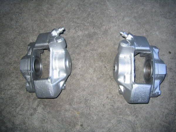

Kev had to also "remodel" the calipers so that they would clear the LS contessas. Only 1-2mm off each bleed nipple lug. The left hand one was a perfect match however the right hand one still touched, but only just...
So tonight I will angle grind away 1/2mm to get it clear off the wheel and then all that's left is wheel alignment. Then I will have a "sleeper" Mini K! no flares! yeah baby :twisted: :P Group Nb racer spec :lol:

Here are the pics as promised. I tell ya they fit snug under the arches without flares. Full sleep look style :P Lillee is one more step closer to "S" spec

These calipers fit so close in there.. :shock:
No room for stick-on weights, even in the middle!
Inner ones need to be clip on and `ping' off style. :lol:

With the brand new calipers I bought, there was no way they were going to clear on LS contessa's. I thought of spacers and even then, I don't think so.
