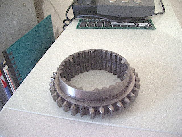

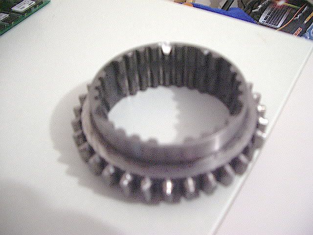

ASSEMBLY TOOL FOR BALLS INTO SYNCHRO HUBS
I have not lost a synchro ball on assembly since making this tool up.
TO MAKE:
1. Get an old 1st gear, either a 3 synchro one will do. (all the splines are same inside anyhow).
2. Look inside where the balls ran, there are 3 shiny marks, between the cutouts for the baulk ring.
3. hold gear in a vice with the cutouts facing downwards.
4. Take a 4" angle grinder with a well worn cutting or grinding disc on it.
5. Grind a 45* (approx) angle about 6mm wide, into each gear tooth where the marks are. ie equal spaced.... 3 required.
TO ASSEMBLE:
1. Put this tool on the bench with the 3 grooves facing up.
2. Fit your synchro hub (either one you are assembling) inside it from top. Fit the 3 springs. Sit the 3 balls in the grooves.
3. Push the hub into the tool. the balls will run down the grooves and into the hub.
4. Put the outer part of your synchro hub on the bench. Put the tool and hub assy on top. align the synchro cutouts of ring with those on the hub and then push the hub down thru the `tool' into your synchro outer ring.
See pics..... sorry they are a bit dark... :wink:

Here ya go Doc, added a little light on the subject for you :wink:
