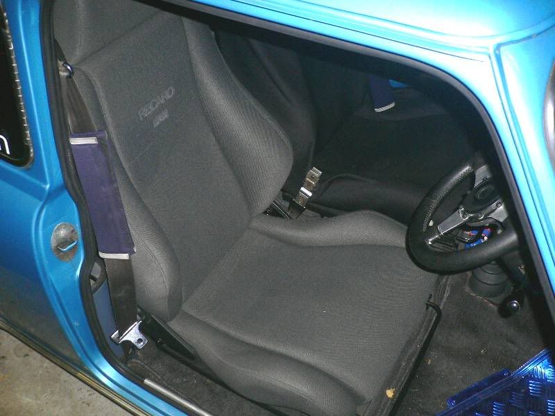

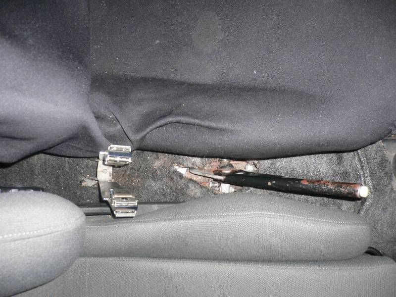

I have the exact same pair in my car, they fit no worries, I even have plenty of room between the seats for the handbrake..
You do lose a bit of adjustability going back though, mine foul on the rear door bins (the plastic adjuster on the sides) but i'm 5'11" and this doesn't bother me. I love them, they're great :mrgreen:

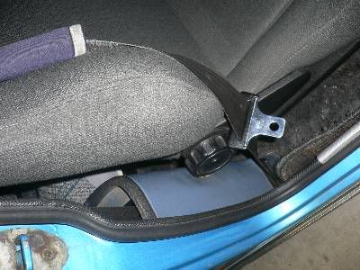

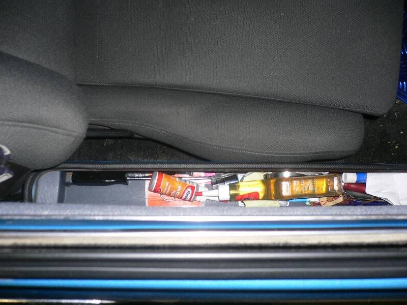

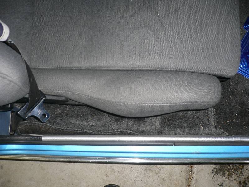

I'm not sure what you mean by adjustable base.. The seat will slide forward and back, but the base doesn't tilt, the rear is adjustable for angle and you can even flip them forward from both sides of the seat..bonus!
Seats From Outside:
Drivers Door Open:
Gap with Drivers Door Closed:
Distance Between Seats:
The Adjuster Knob just fouls on the rear door bin, but you could take out one screw and remove the knob and you may get a little more room to move it back.. I didn't bother.
Sorry..forgot to rotate it..
Just another Shot..
