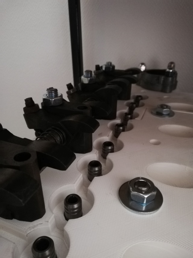

The first of many steps was to determine the location of the important components of the cylinder head, i.e. the studs, the rocker arm passages, the coolant passages and the oil passages.

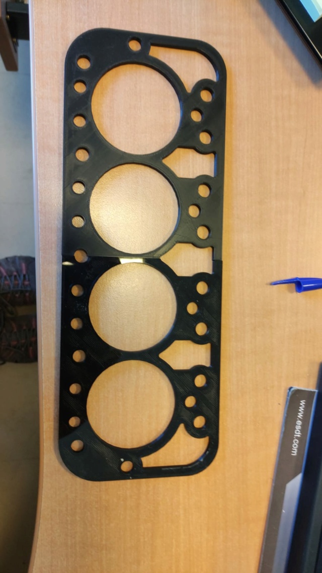

Once the elements had been designed, I printed them out to check the accuracy of the design.

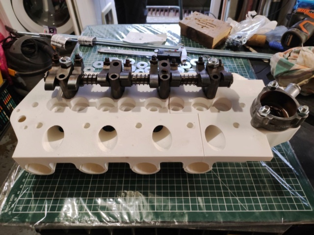

finally, after a few (many) hours, I managed to get a complete design
I've printed the whole thing out to check it.
but as it's a big piece, i had to do it in four parts, you can see the joins and the lack of detail, effectively it's a lightened version because concerning the time it's the equivalent of more than 4 days of printing 24/24.
threaded rods are only used to hold 3d printed parts in place :lol: .
I won't be posting any photos of the chambers, final ducts or intake manifold for the time being. However, I hope you'll be interested in the project, and I'll be happy to talk about it.

What a wonderful job you have done, congrats.
PostPosted: Thu Aug 03, 2023 1:07 pm
Posts: 860
Greet project, looks like a lot of work to date, and a long way to go for the final cast iron product. Keep us posted!
PostPosted: Thu Aug 03, 2023 1:25 pm
Posts: 18888
Wonderful work! Certainly, has to be enough for a 4th year Ind. Eng. design Thesis at as minimum!
Can your modelling indicate performance at part-throttle or transient load response as well? I'm really interested in the modelling, it's a brave new world in design.
