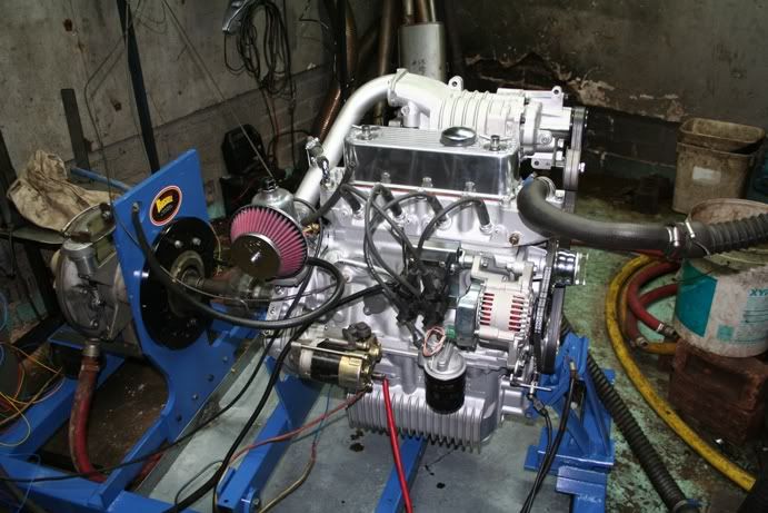

PostPosted: Fri Oct 14, 2011 6:24 pm
Posts: 3166
Yeah! Another update on the engine . :twisted:
How about 155HP @ 6500 rpm on the dyno with approx 13lb boost :) :) :) :) :)
142.8 ft/lb torque @ 4500 rpm
Sounds great.
Had a problem with the Megajolt? It appears to be OK at low RPM with the Megajolt reading 20deg advance and the timing light showing 20deg but at high RPM the MegaJolt was showing 31 deg and the Timing light was showing 41deg
Micheal is your #1 lead 180 deg out
PostPosted: Fri Oct 14, 2011 8:32 pm
sorry Michael...i'v been enlightened on the mega jolt
PostPosted: Fri Oct 14, 2011 8:41 pm
Posts: 3166
If it is I cant wait to hear it running at 6500rpm when the leads are connected correctly :twisted:
Nope all good just some crazy readings between the Megajolt and the timing light?
