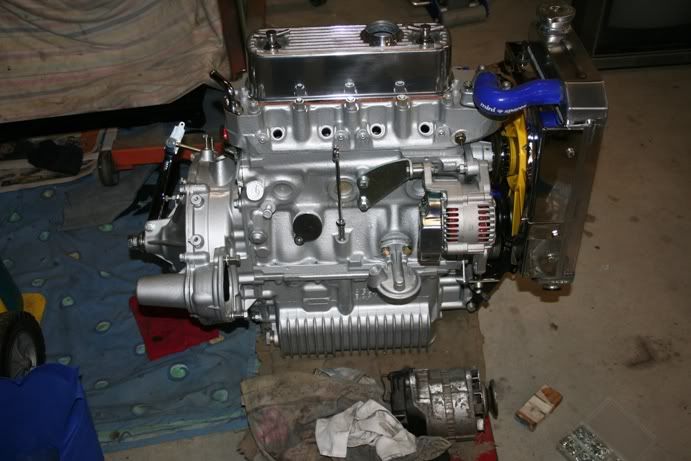

Finally found time to do some more work on the engine.
Fitted a Suzuki alternator.
The old one is about the same weight but much larger
Then fitted the starter motor, oil filter, dip stick and supercharger
Have to clean the carby tommorrow and fit
Almost ready to start. :shock:

PostPosted: Sun Jun 12, 2011 9:51 pm
Three random questions:
1. What year supercharger is that?
2. Who determined the pulley ratio the blower runs at?
3. Is the slot in the alternator mount the only form of belt tensioner?
:D
PostPosted: Sun Jun 12, 2011 10:13 pm
Posts: 3166
Supercharger is an M45 from a Bini, not sure of year but probably 5 or 6 years old?
The kit is from VMAXSCART and he supplied the pulley
And I havnt finished fitting the alternator , it still needs a bracket to fit for tensioning the belt, and I also need to buy a belt
