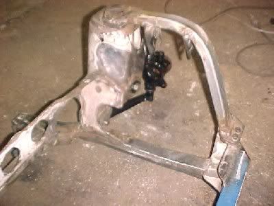

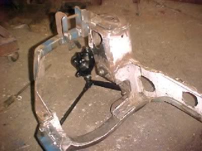

PostPosted: Sat Jul 02, 2005 7:55 pm
Posts: 338
With my subframe I have the main braces under the engine then ones over the top bolt on holding the engine this was to distribute the weight of the engine a bit better not just hanging off the supension towers. Put some of the weight underneath more like a standard mini.

PostPosted: Sat Jul 02, 2005 10:08 pm
Posts: 1145
Location: ACT
Wow 92, it never ceases to amaze me how many different ways there are to skin a cat. Great effort...
