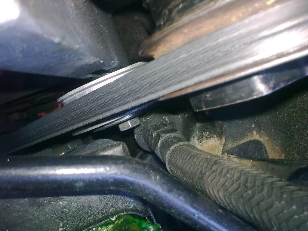

Anyhow... my real reason for replying is that i've caught the forced induction bug and have decided that i will go down the sc12 route. I had put it off in the past because i was told that the sc12 kit wouldn't work in hydro cars. How have you got around that issue. Yours is clearly hydro, i can see the lines there. Do you have any pics of how the kit clears them?

the hydro pipe is fairly simple it needs to be re mounted to the right as far as u can move it. I did mine without depressurising the system by cutting the old mount and welding it to the body off to the side as shown below. Is fairly messy looking though.
Theres been a few ideas going around that i really like the sound of but cannot afford at the moment, so ill be trying competition bump stops and lowering my hydro pressure, possibly some front coilovers in future along with disks

hmmm... so you can make the kit work with a hydro car. I can't quite see what you're trying to show in that pic. But the bottom line is that it's not a special hydro-friendly kit.
